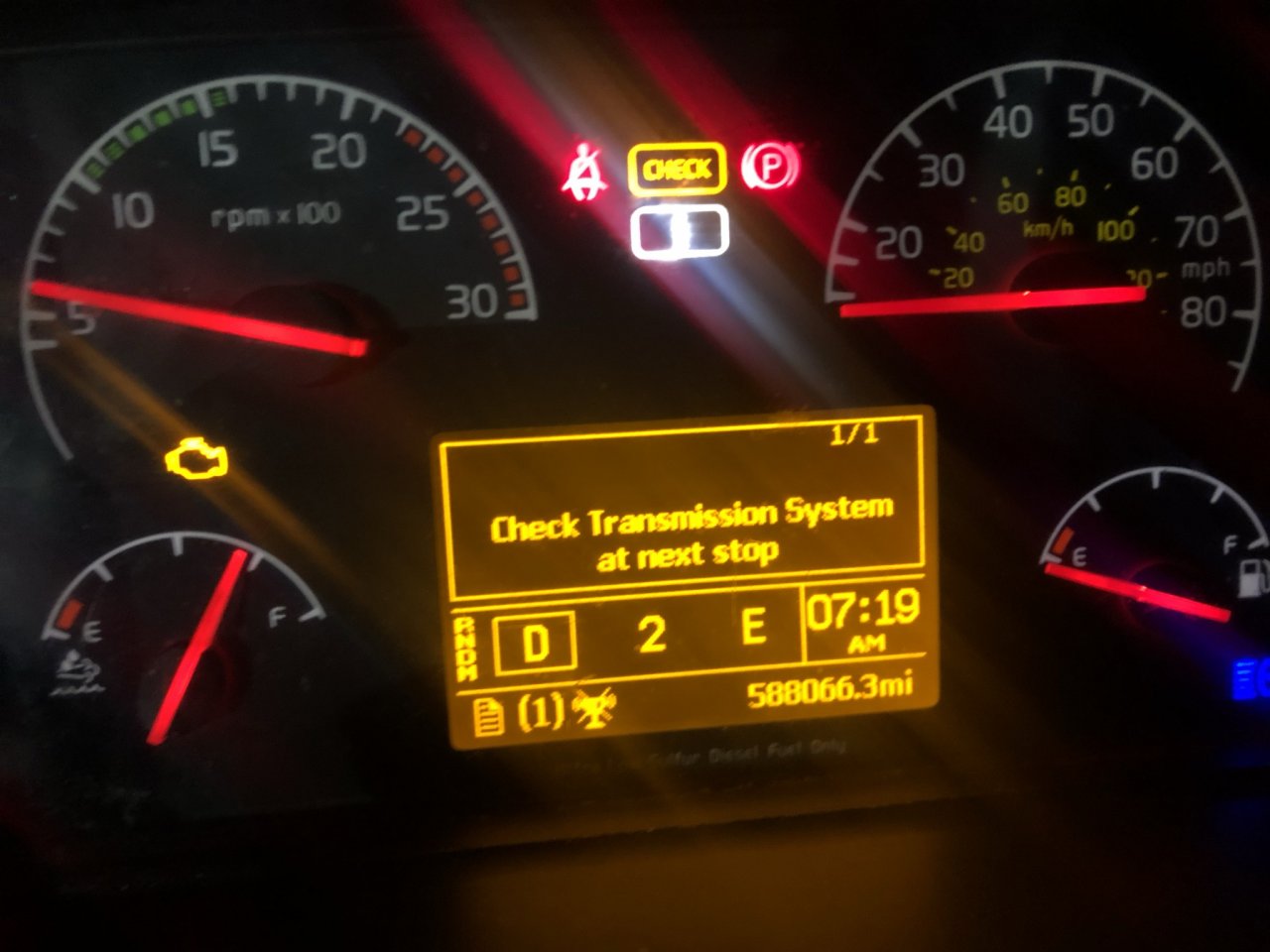

    The shop is telling me I needed that sensor. The say thats the code that they are getting.
    Heres my issue. When I step on the gas pedal the trucks is jerking forward as if slammed on the gas pedal, Its also delayed.
    Secondly, when I put it in reverse it wont realize its in reverse until i start pressing the pedal. Also delayed, and it Jerks.
    Lastly when I put my truck from Neutral to Drive, the truck goes from E- mode to L- mode. When I looked up L mode its stands for Limp Mode and it wont allow me to drive. I have to shut the truck off and on again for its to go into E mode.
    The transmission is not slipping, and it shifts fine. But I am getting the same check transmission message, and I also do get the low air for transmission message when I first start the truck after its been off for a while.
    If you or anyone else has experienced it please feel free to share.
