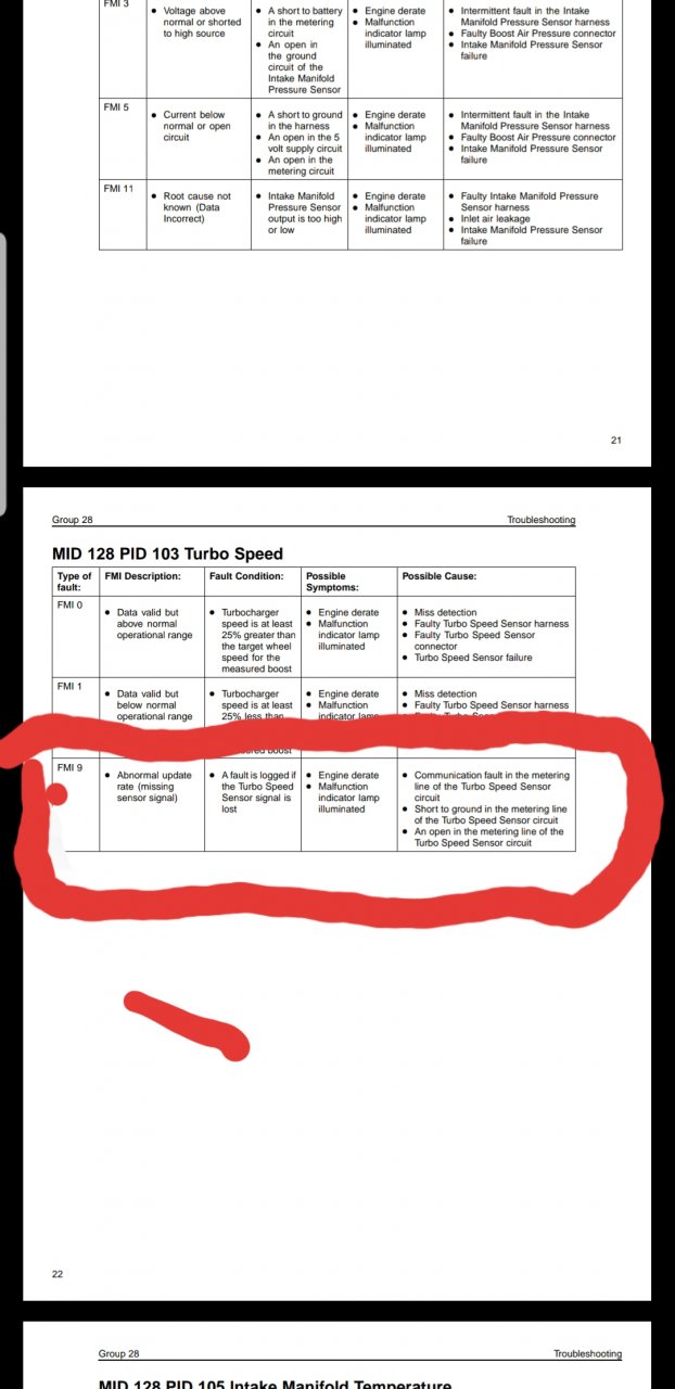

    Not on the intake .Intake is good im talking about the turbo speed sensor located on the turbo its self
  3. Volvod13vnl
    Volvod13vnl Bobtail Member
    19
    4
    Mar 4, 2019
    Did any one had this code please help mid 128 pid 103 fmi 9 turbo speed sensor but is it ok for the turbo speed sensor to be covered in engine oil is that making it to throw the code?

    Yes,some how in the housing i had two O rings,I know while back it was replaced in a shop in Chicago area,the mechanic left it in their so i removed the o ring no more codes.(Only 1 oring the one thats comes with the sensor)
