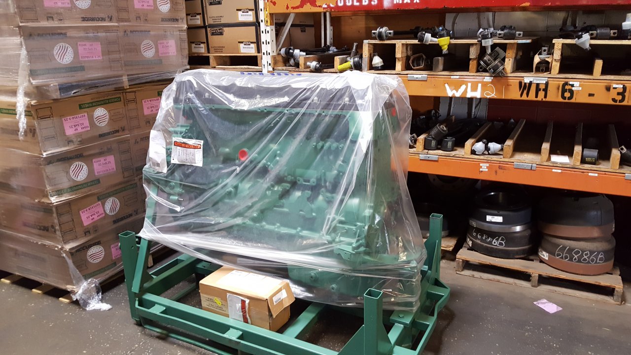

    Ok, had few problems but not mechanical , the shop swapped the engine ,it came with injectors installed and they did not upload the new injector trim codes, because comes without ecm . The sludge i had was most likely caused by my thermostat was defective , stuck open kept the coolant /oil temp to low causing condensation.
    I passed the 350k miles warranty threshold , i have 405,000 miles on motor , now even if breaks down it paid for itself . If i would have to chose again between buying new 160k$ truck or a 20k truck used as i did , run it 200k miles before i put a reman motor, i would do same, i purchased last truck new and five years high payments are stressful. I prefer less monthly payments, still warranty security and freedom to work as i want park during our Canadian winters.
    It came as you see , with injectors installed, oil cooler and a box with all gaskets, you can order the kitt with with turbo if you want.
