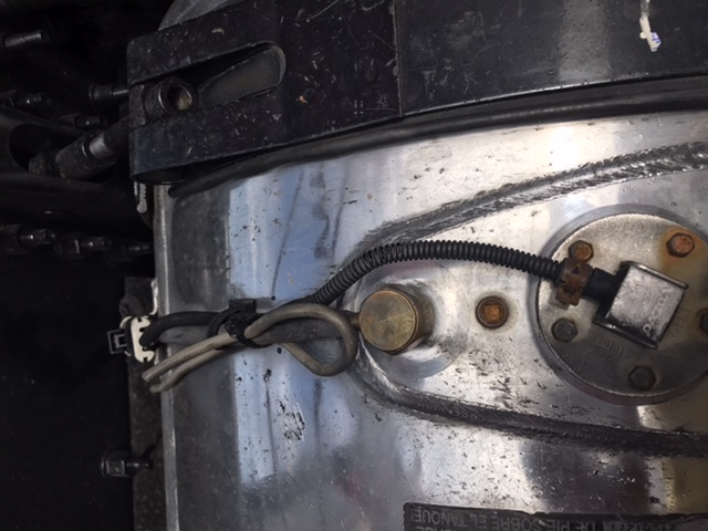

    Anybody familiar with the cut gray wire? One cut on each fuel tank and zip tied. Followed the rioting and both wires enter just underneath the fire extinguisher on drivers side door

    My truck doesn't have any wires like that. Maybe it was used at one point to link some lights on the back of the truck to one of the dash switches.

    yes, this is a modification, rather it was additional lights
