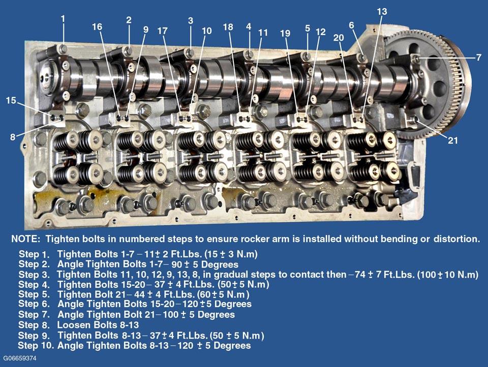

    Nasriza, I need your expertise again. I have removed five injectors but the injector in the #5 bore is stuck. I have tried to gently pry it making sure I don't cause any damage to the head but it seems is stuck in there pretty well. The H.C.B-B1393 tool I have is to remove/ install the sleeve but I don't have any injector puller. Any suggestion?

    Will do, I had one final question on the torque specs for the rocker arm shaft but I'll call you later for that or if you can pass it on here. Very much appreciate your help!!!
