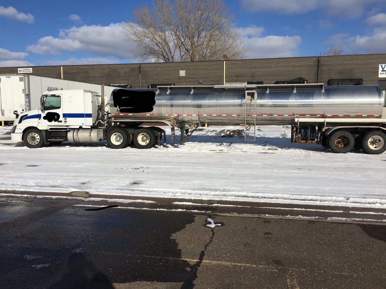

  7. Fold_Moiler
    Fold_Moiler Road Train Member
    1,926
    3,529
    Mar 17, 2017
    Mine, rusty wheels have been replaced.
    Lepton1 Thanks this.
