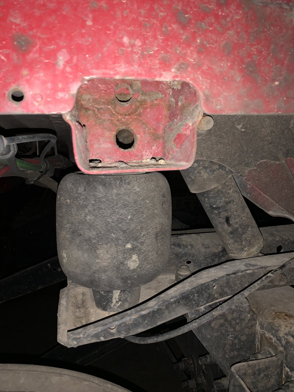

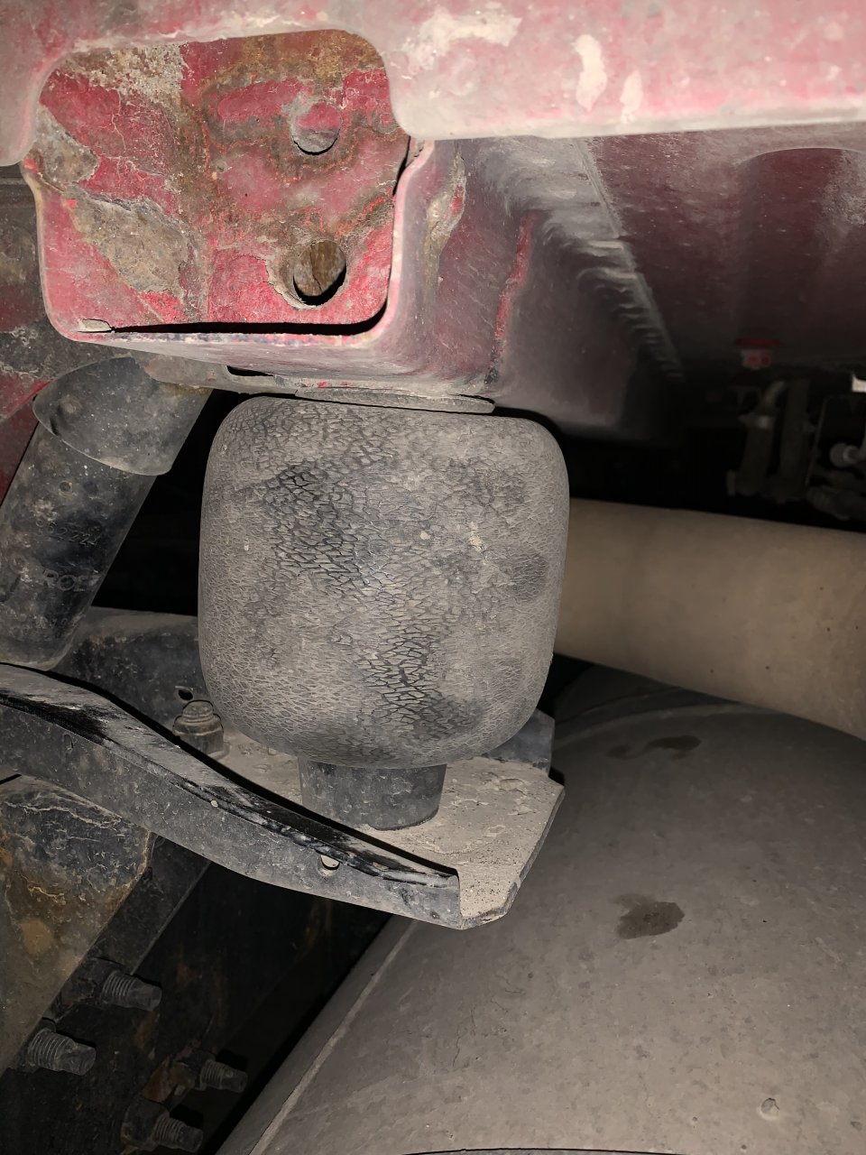

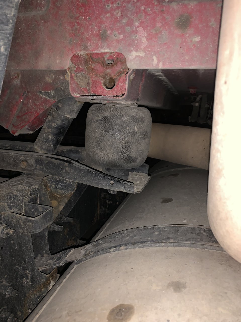

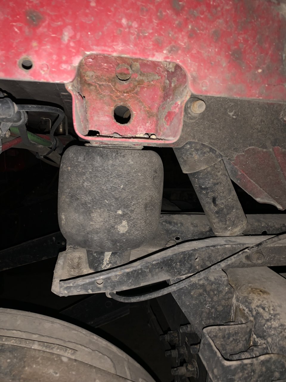

    I replaced cab level and cab air bags and everything is set tight but I don’t know how to set properly cab height

    If you want to eyeball the adjustment, you want to set the height so the air springs aren’t sitting too high up off the base, but not so low that they look deflated.
    Post a picture of the back of the cab with the air spring inflated and I could tell you if it’s set right.

    I D6CA7A7F-E612-4D35-A3FE-CA0065E91BE8.jpeg DC0118F6-1BF6-4E6B-8A62-B62E6FA9AB87.jpeg 49C2AB01-C439-473F-B088-B7116CF3C07B.jpeg 8DC4682A-7879-4062-A546-277F40B73CD9.jpeg I set air spring to set shocks to the middle of top and bottom points

    That bar was replaced too
    Will try to make lower thank you very much for helping
