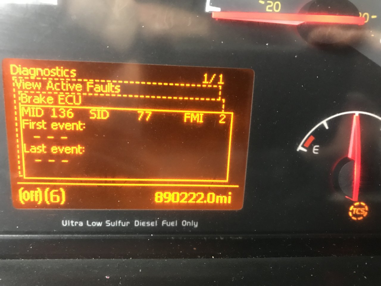

    Hello fellas. I have volvo VNL 670, 2011 with cummins isx 500. Have this tcs light for a while. Since that showed up before i start my truck used to puffing air like doing some check and now its gone, that puffing is gone. If it’s the air pressure switch where is actually located i cannot find it. Please for help! Thank you guys!

    Is your truck still running ok?
    I read that TCS faults causes engine to derate , reduces your power and self applies brakes at lower speed. I got it the TCS fault this week , after replacing steer axle leaf springs, somehow the spring shop boys messed my steering wheel position and had to take it to Volvo adjust and recalibrate the angle sensor with Bendix program. I read the TCS system uses data from abs , steering weel , crankshaft , esp sensors.

    We can help only if you can post faulty codes.

    Okay. Yes, i totally forgot about the code.
    I will post a picture.

    Brake Ecu: MID 136 SID 77 FMI 2

    My truck is running fine for now, but this tcs light is giving me a headache. Last time 2 years ago i got this tcs light on, after 30 minutes driving or so my passenger drive axle got on fire because of a broken wheel seal. parked on shoulder and firefighters came in because somebody call 911. After they left i was gonna go to closes truck repair, while doing u-turn, the whole drive axle fell off. $5000 less in my pocket. I hope this time it will be sensor or something, since i cannot see any leak or something around the wheels.

    i would take it immediately in good shop and have it checked, could be the steer axle, steering column, even more dangerous. Don't play Russian roulette , maybe next time you run out of luck and hurt yourself or other people around you. The abs fault are most of the time caused by wire corrosion, salt dirty and sensors, valves but ... in the same time is the only sensor that can warm you about hub, axle problem ( and axle oil temp, not as efficient) , can sense bearing movement give bad readings if oil gets out of hub. The DOT puts you out of service for abs . Any other engine and emission faults wont indicate a threat to drivers life; you can still pull on the shoulder with dead motor but not without wheels.
