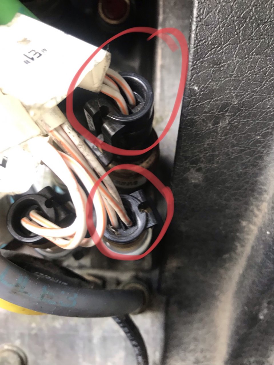

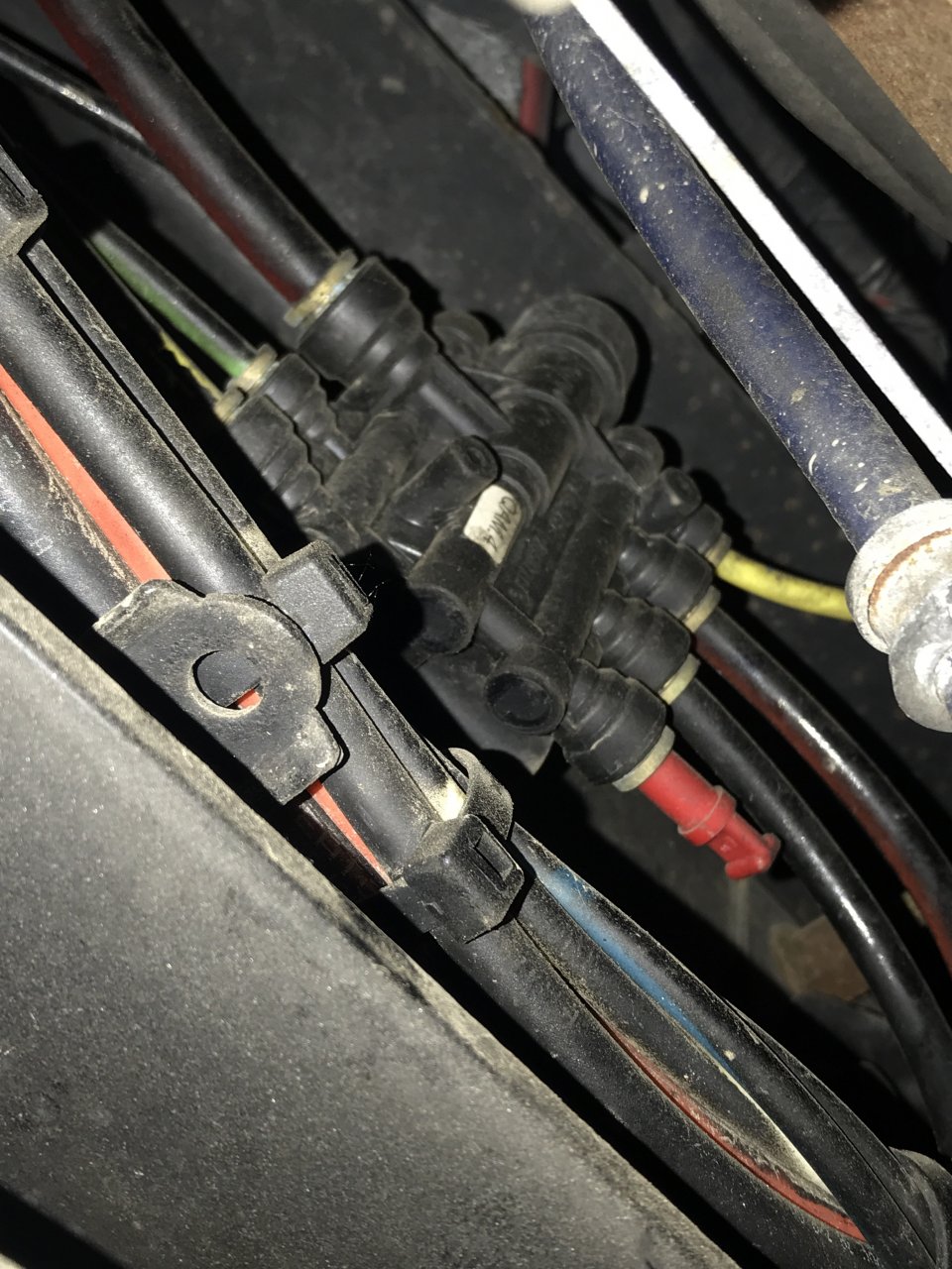

    Is this the air manifold ? I feel like i’m looking on the wrong spot

    No. Inside cab. Plastic panel where your tilt steering wheel pedal is. Remove plastic panel with T25 torx driver. You will see air manifold. Pressure switch in lower left corner.

    I think i found it. It has 3 like this they are same number i tried to switch them to see if any changes but nothing. The left bottom one i think is from the airbags because when i took it off it start bleeding air and airbags dropped. And the right bottom i took it off and its leaking only when i apply the brake pedal. Just to replace the bottom right one ?

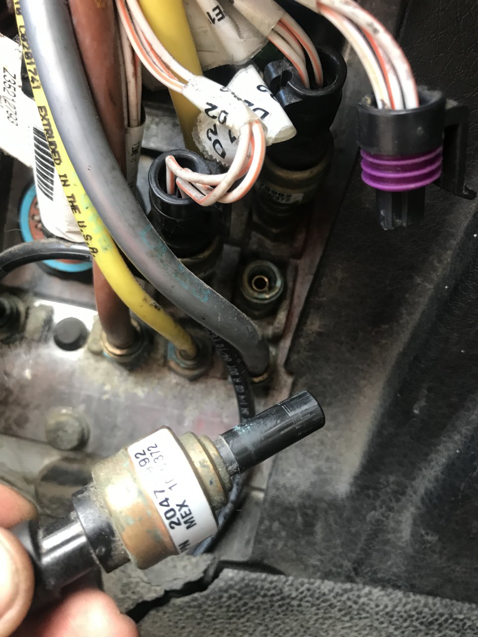

    Here I’m back again. I have to say thanks to everyone who tried to share their knowledge and helped me. I did replace these sensors, so code MID 136 SID 78 FMI 2 stands for the top sensor and the MID 136 SID 77 FMI 2 is the bottom one which i will post picture. In volvo they have some cross number for that part and it is #22443498. I will show also post pic. Thanks again.
