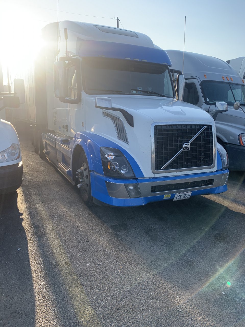

    I had replaced my horrible lights in the 2014 I had and cost $1829.01 with some that required a quick up date on ECM but was plug and play. They were great on the low and highs. Ran most of the time on low and had no problems. I hate driving at night if I cannot see so it was a must for me. I will try and find out what the name of them was. I did get them from the dealer in KCMO (Nextran) Used to be Westfall. IMG_1957.jpeg

    You can buy the cheaper ones as well but these are OEM style that come from a OEM supplier. I had bought a pair from Iowa 80 that had great lights as well. Only problem with them they did not last but about 6 months. They had broke and moved around inside the light assembly. Those were these Volvo VNL Blackout LED Projector Headlights but they would freeze over. On the OEM ones they had the Daytime Run lights on was a regular light bulb so it would keep the area warm and not freeze.

    With me the yellow old style lighting I just cant see much. With the LED lights I can see all the details in shadow areas/ DEER and other critters of the night. I was driving my 14 right outside of Salt Lake City going back to MO in the middle of nite and almost hit a few deer. Scared the hell out of me because I did not see them at all until I was right on them. That night I decided the cost of LED was not much compared to a wrecked truck. Bought the ones I posted a link to above and loved them a lot until it was winter time. They froze over and I had to stop to clean them off. Then one day I was driving and seen my lights jumping and shooting up into the trees. The clips that hold the ELD assembly broke off in both lights. I had to throw those lights in the trash and got the OEM ones and will never buy another kind of LED for truck.
