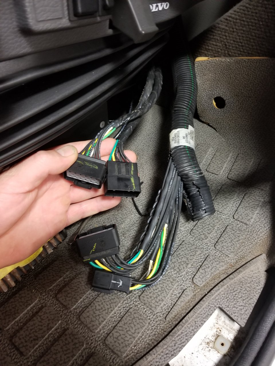

    Good morning. First I wanna thank you guys for trying to help me out with this nightmare that I'm dealing with. Here is what I found, if I disconnect the green and yellow wires on one end of the plug and black both black wires on other plug ( don't know why they are black) right by the battery box ,my turn signal warning works I have turbo gauge working, no more brake ECU and no more light control module. Gas pedal response like it should . Here is what I don't understand , also I unplugged the 2 plugs right by drivers seat which are for the shifter (I have 3 pedal autoshift with push button) each set of plugs have data link wires green and yellow, one plug data link wires don't have continuity it shows 0.00 other plug which comes out also from the shifter side has continuity of 119.8 120.0 or so again testing both plugs on sifter side. I'm wondering if I have shifter it self shorting out and sending wrong signal to all computers. What your thoughts on that. Thanks again Andy. I'll try posting some pics.

    Shifter plugs

    The ones I'm holding are going through the cab and on floor board to ecm's

    Shifter plugs
