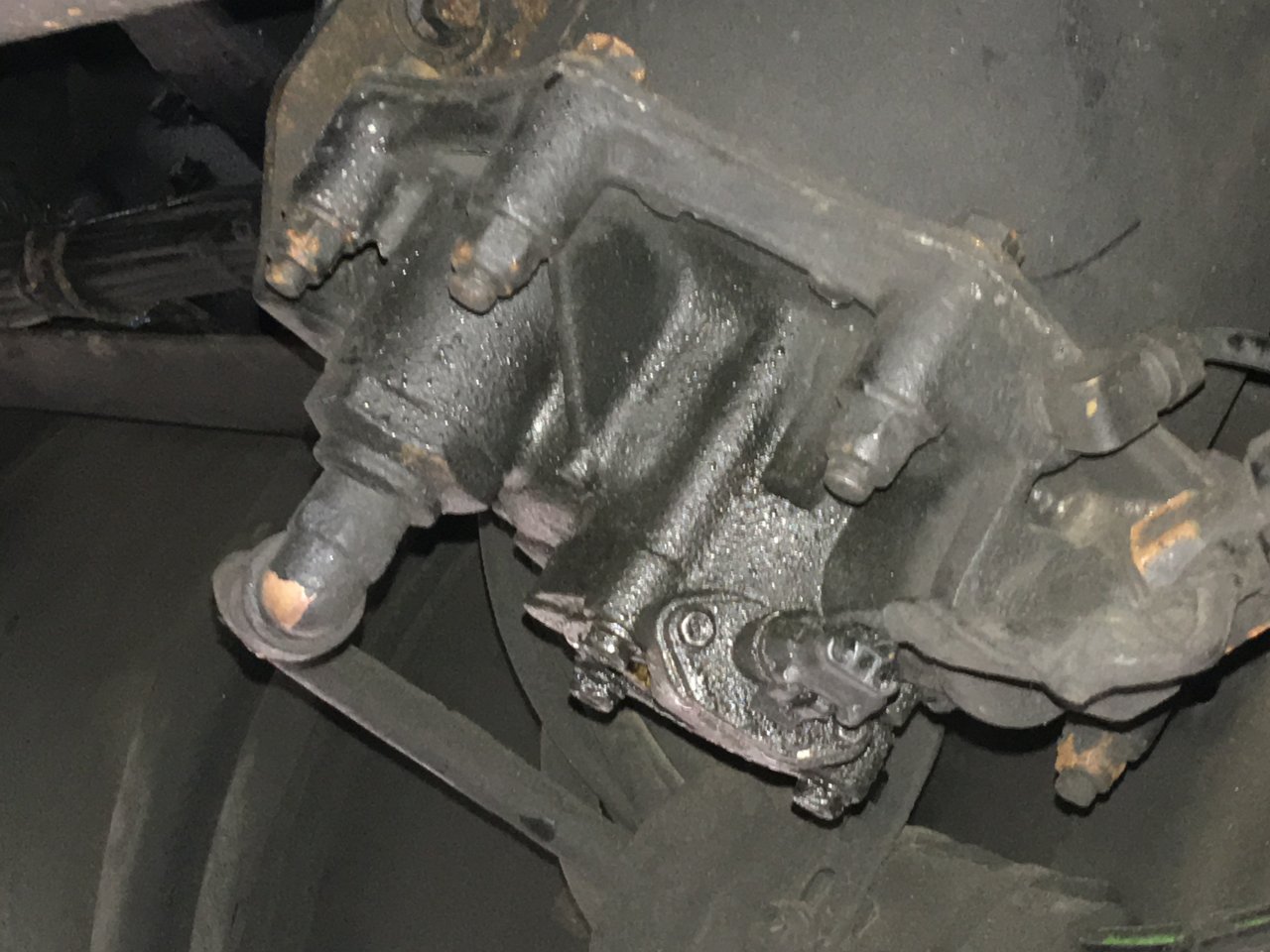

VT830 D16 550hp got a code for retarter overspeed

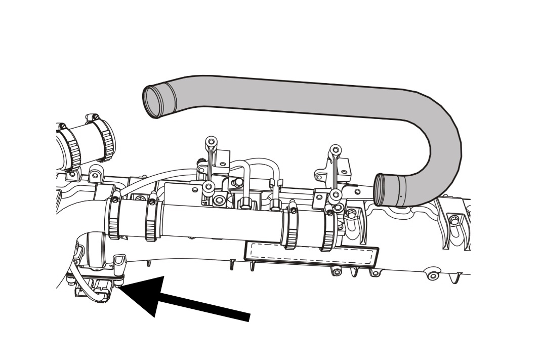

    You might be better off to verify reading off that module with a Volvo software or aftermarket ones that shows egr differential pressure reading.

    Thanks, I check to see if the previous owner disconnected it. Is that a 07 model engine, my don't have that big thingy over where you have the arrow.

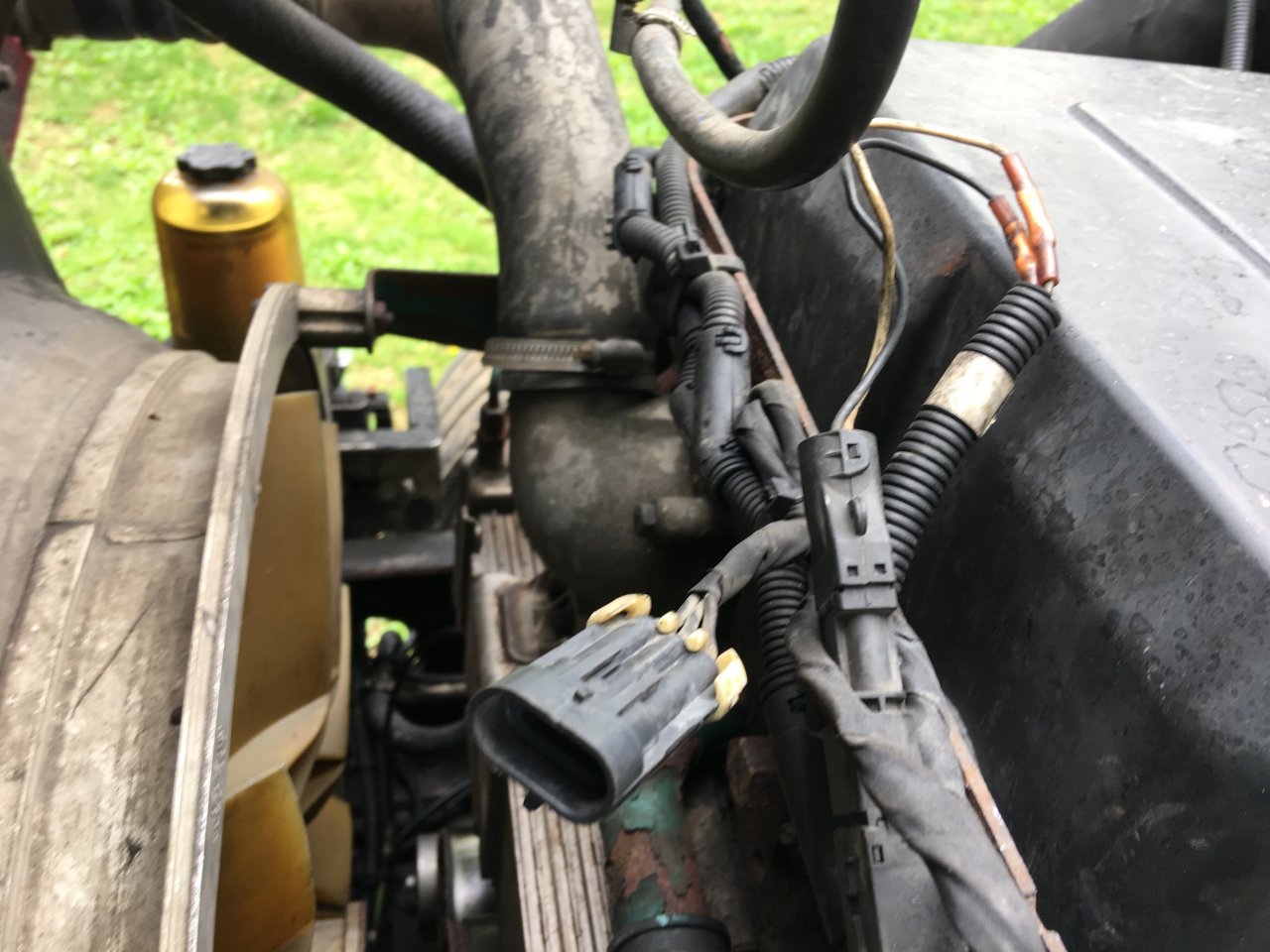

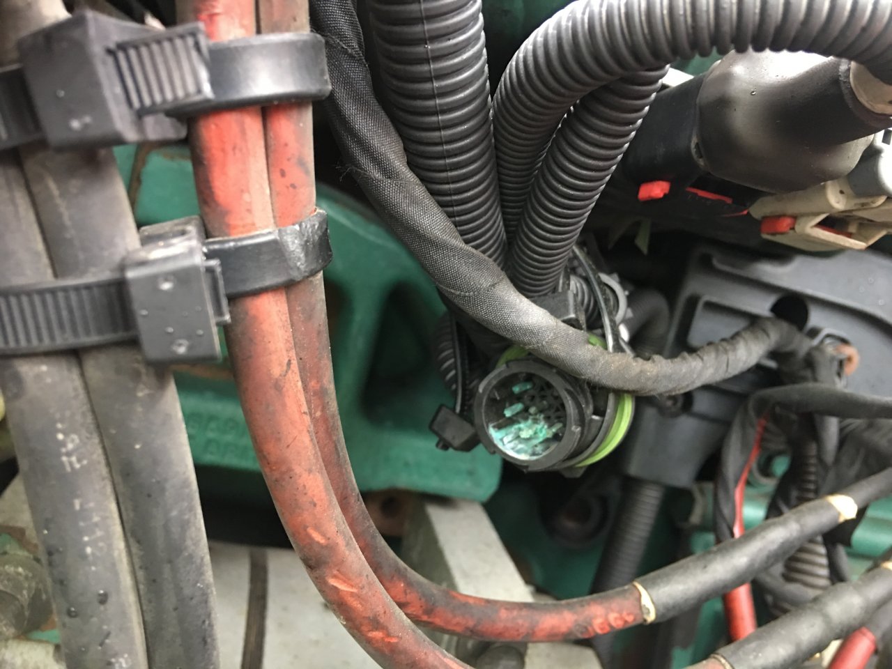

    Post a picture of your engine from both sides on here, you can do it straight from your phone just press that “UPLOAD A FILE” button

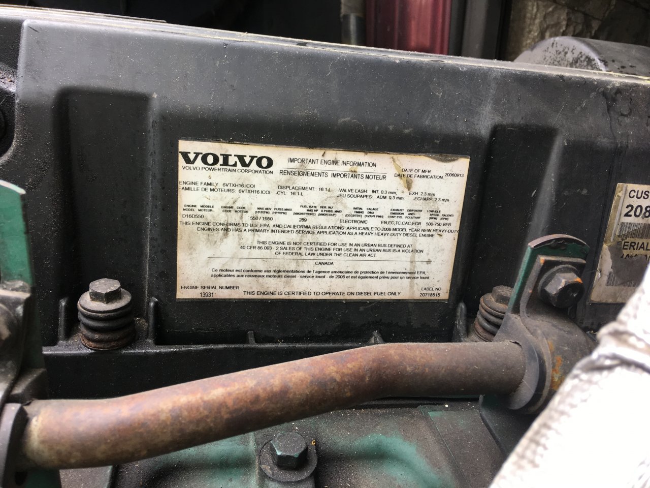

    How long do you own this truck?? And there’s a white sticker on top cover of the engine driver side(you can see it on the last picture) that tells what HP this engine has. If you can post it too it would be helpful

    Got it at the beginning of April, yes there is I have attached some pictures and my do have that big thingy just naver paid attention to it.

    This is where the EGR is

    The engine serial number matches to the one in system to the one installed on at the factory. Cause when you said you don’t have that cover plate over egr piping I start thinking you might have a newer engine swapped in your truck. They changed the design for EPA 07.
