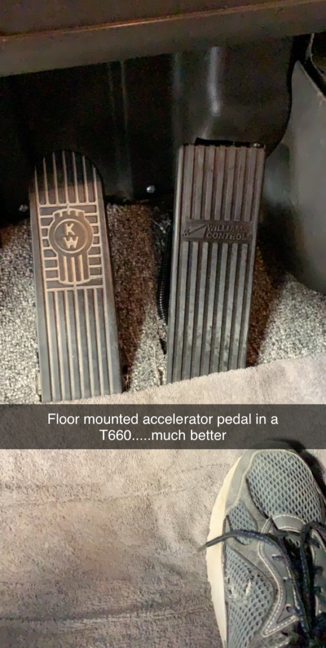

  6. TMS Farms
    TMS Farms Bobtail Member
    3
    4
    Oct 3, 2019
  7. TMS Farms
    3
    4
    Oct 3, 2019
    We have done this conversion in a ‘10 T660 using a Williams control wm-526 402661 pedal assembly. You have to either splice wires or re-pin the short factory pedal harness end onto the new foot pedal wire harness. Fairly simple—we re-pinned since there was plenty of wire lead on the new pedal assembly.
    Vampire, RubyEagle and QUALITYTRUCK Thank this.

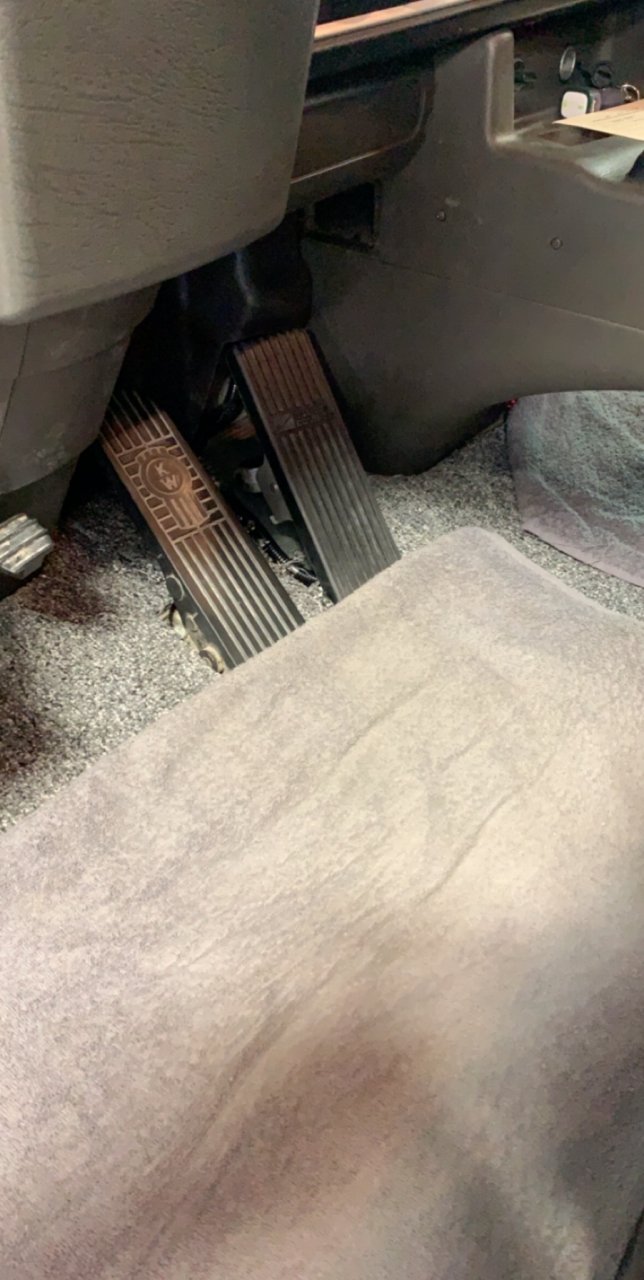

  8. Jeremyjdean92
    Jeremyjdean92 Bobtail Member
    3
    1
    Jun 17, 2019
    I recently did mine as well. However I couldn't figure out the new pinning needed for the new TPS. So I reused the old one from the hanging pedal.
    Vampire Thanks this.
