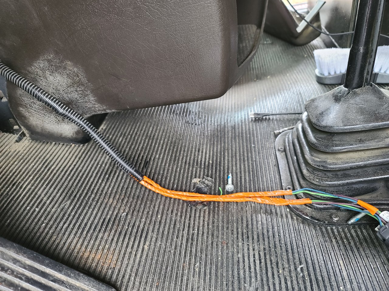

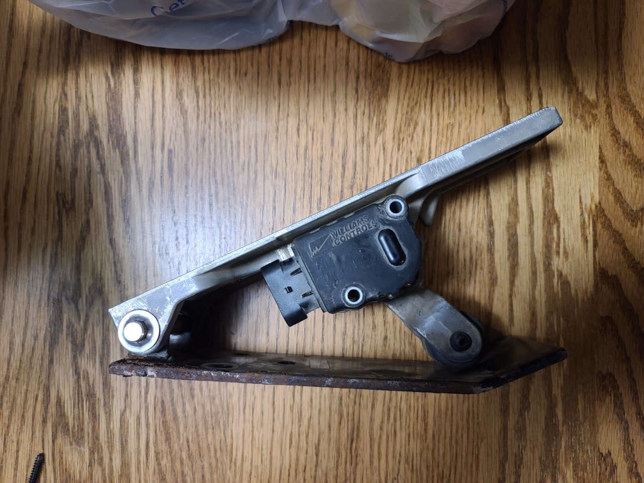

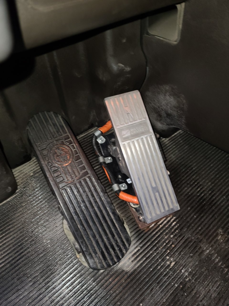

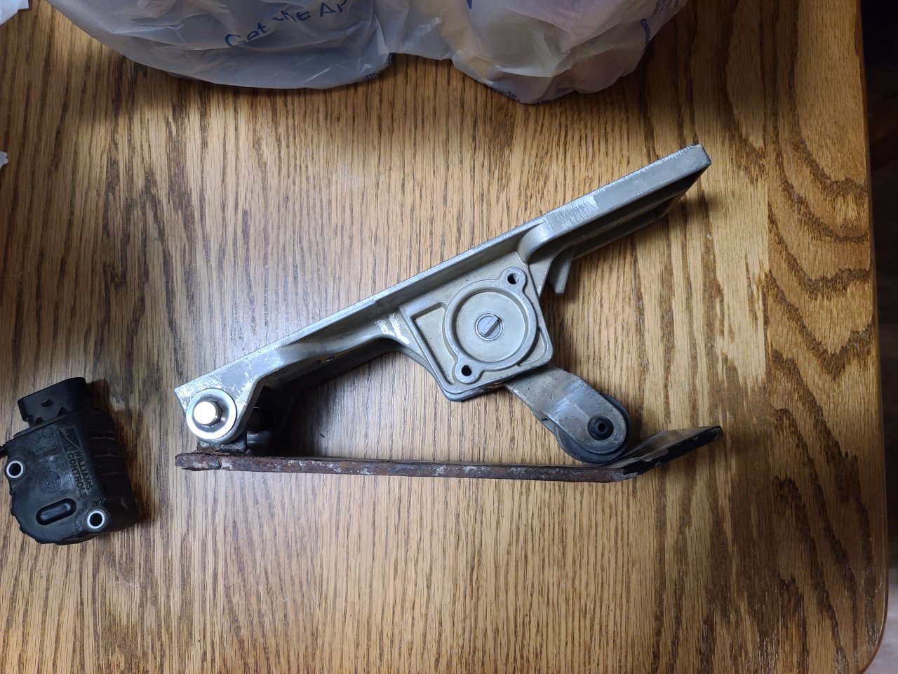

    @Vampire I ended up with a pedal from the salvage yard that had the same mounting holes for the sensor that my stock pedal had.
    As you can see the sensor off the hanging pedal fits right on the old one

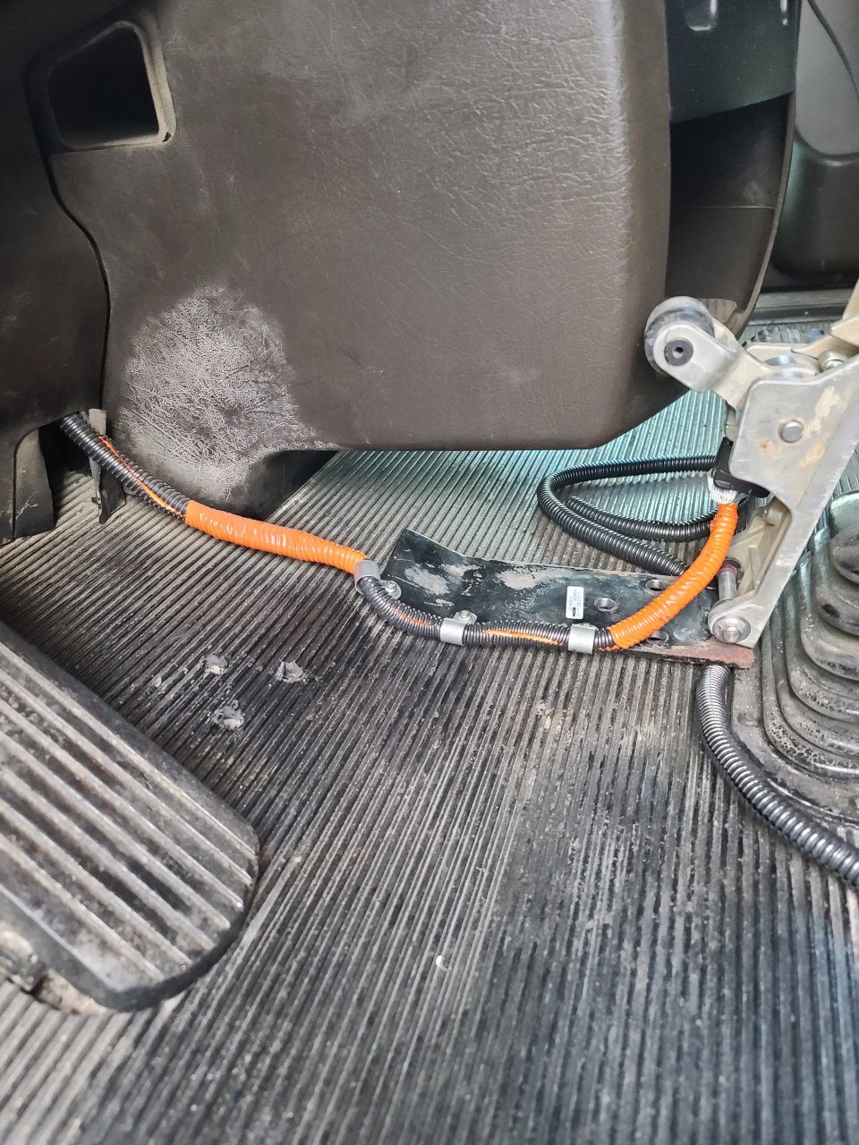

    Ended up having to extend the wires for the sensor about 12 inches in order to mount the pedal and route the wires the way they are supposed to be. There's two sets of 3 twisted wires. They are the same 3 colors in each set, blue, green, and purple. I marked one of the twisted 3 with electrical tape in 2 spots and cut between to keep track of which ones went where, forgot to take a pic of that but you can see on the connector end sort of what they look like.
    After that I plugged it onto the pedal and attached the wire loom to the holders.
    Then it's just position it where you want it with the trim in place to make sure it clears and then drill some holes and bolt it down. Mine came with a metal plate that I used to sandwich the cab floor between.
    It's 1000% better than the hanging pedal. You can rest your foot on it without it going to the floor.
