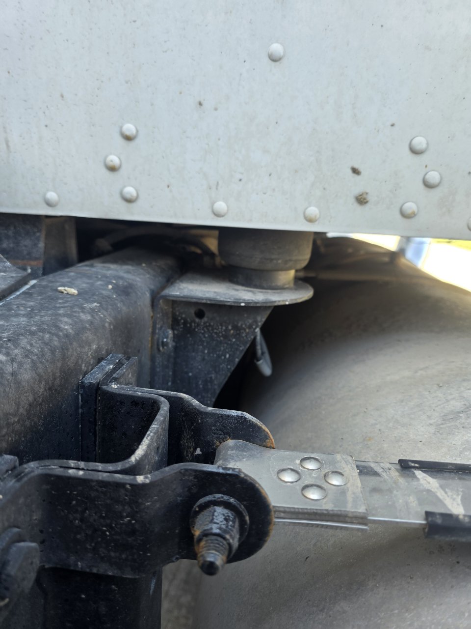

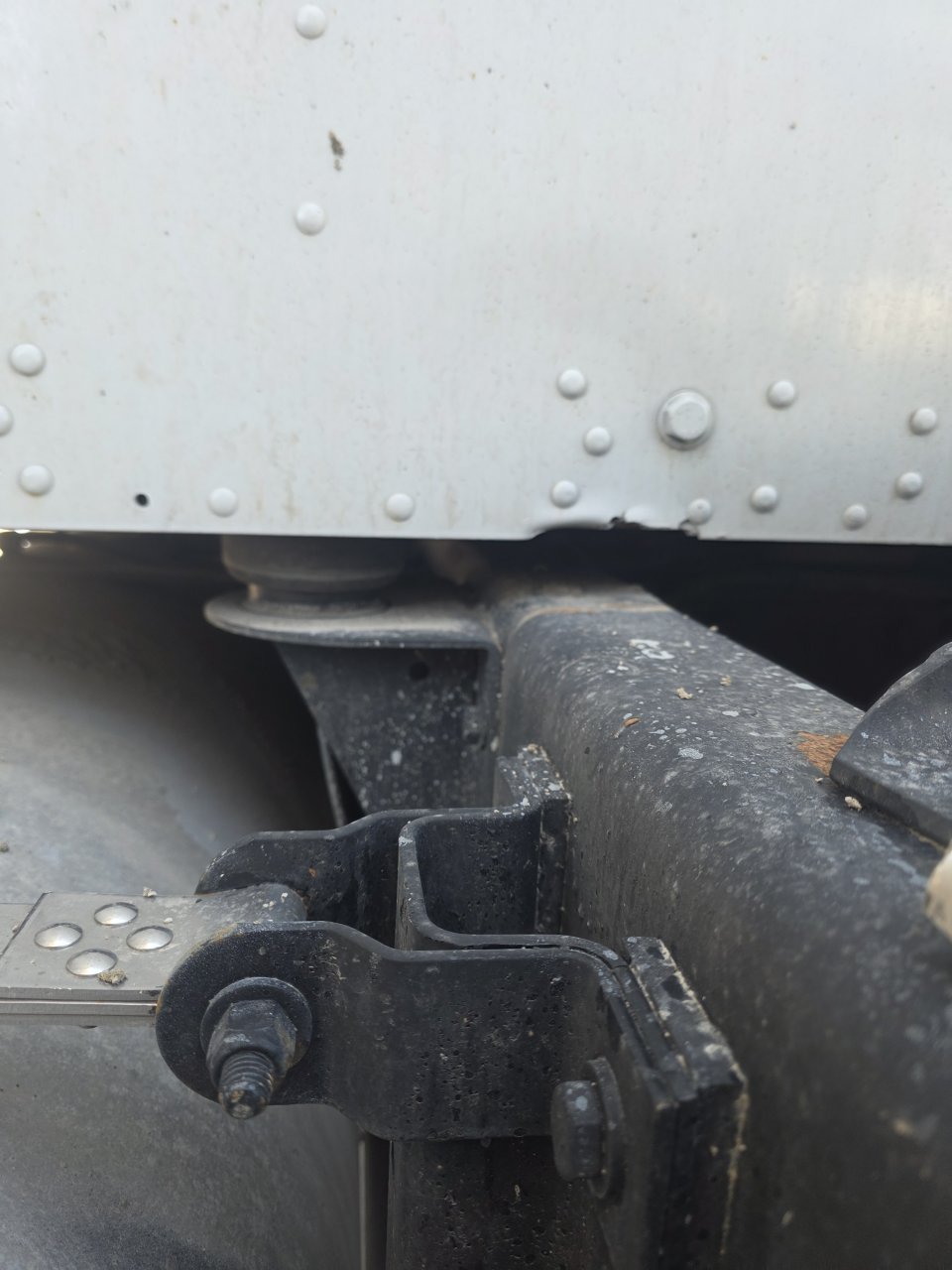

  7. irishluck09
    irishluck09 Light Load Member
    296
    183
    Nov 24, 2019
    Im going to have to double check them again. Ive pretty much given up on it at this point . I replaced the cab bags and nothing changed. Driver side still sits lower then passenger. Ill try and snag some pictures of the cab mounts and see what ya'll think.
    Oxbow Thanks this.
