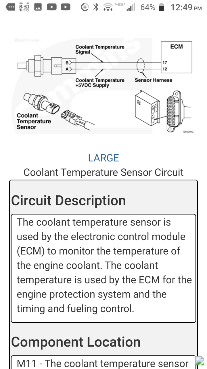

    Sorry for being late to the party, but here is the information that I know. Coolant temp sensor is a 5V two wire thermistor. Screenshot_20210426-124942.png

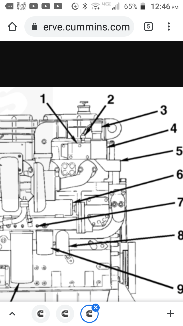

    On the N14, the sensor is located on thermostat housing, item #2. Screenshot_20210426-124617.png
