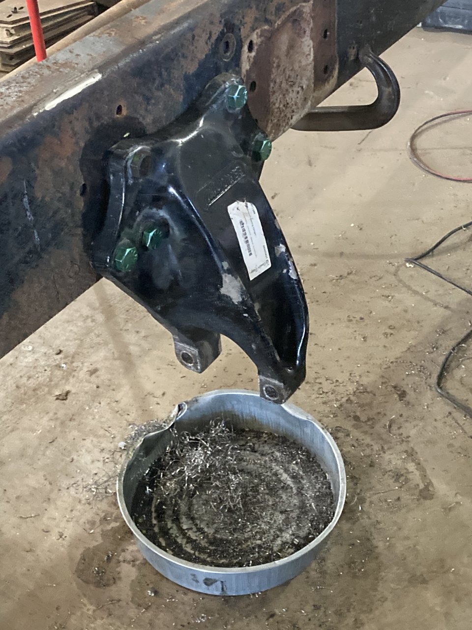

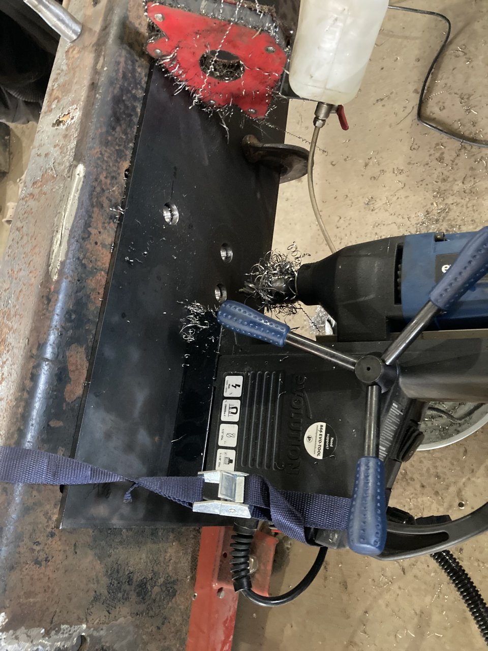

    I am debating upgrading the front axle
    It’s currently a 12k but I am guessing maybe could be a 14k beam. Honestly I am more concerned about the frame horns and front spring hangers. I do have a new 20k axle that I might put under it but if the rest isn’t strong enough what’s the point. We are doubling the frame and upgrading to 46k rears although the heavier rears are more for the drive components and air locker than anything else.

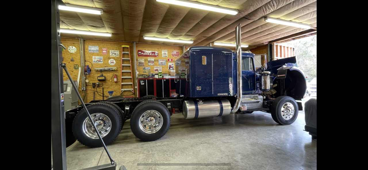

    Also, for just an engine swap, if outside, get your new engine ready to pop in, old one ready to pop out and just hire a wrecker with a boom. The guy that owned this truck before me did that in his gravel driveway, new engine was in back of his dually, think the guy only charged him 4 hrs, was just him and wrecker guy. Was 2 weeks from parking it to rolling again and he was flying solo on it

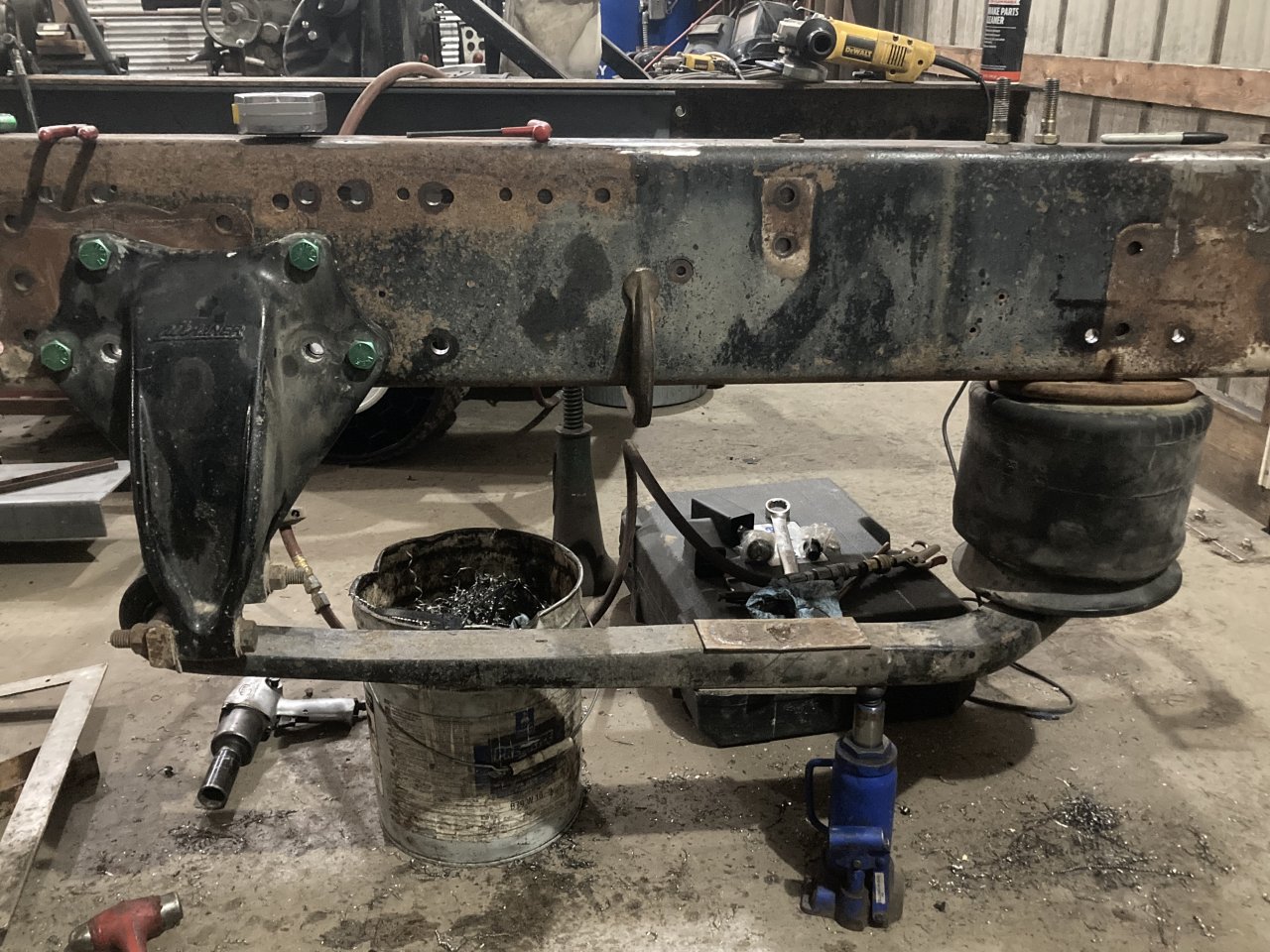

    Sold my friend a Freightliner air ride for his KW A model, I thought it turned out pretty nice.
    Be a nice build you have there, appreciate you sharing it with us…
