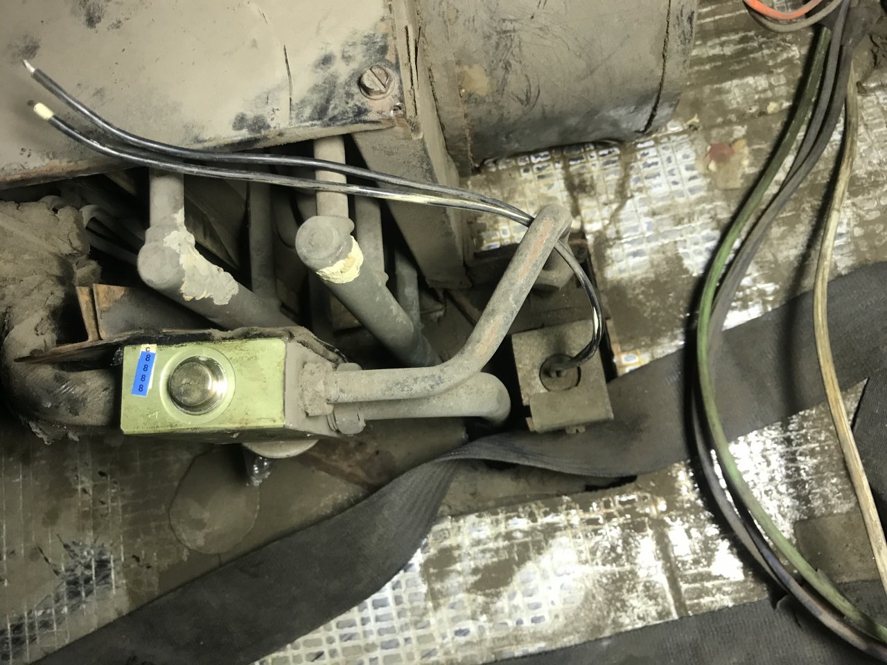

    5AEC1743-AF52-44BA-9F8C-F2EB10408854.jpeg Replaced expansion valve, dryer, trinary switch, and replaced some of the leaking duct work. Added 5 cans, it’s blowing cold but not as hard as I’d like. I’m not getting any cold air out of my sleeper vent but the blower back there is working on both high and low, with the switch. So, the question is, is the cold to warm rotating switch not working or the expansion valve at the rear evaporator core not working? Here’s a pic and there’s some kinda little switch that both wires( black and white) have been disconnected? All y’all’s help has been hugely appreciated and let’s keep it rolling in.

  3. Rideandrepair
    8,095
    16,696
    Aug 8, 2015
    I’m not familiar with Kenworths, but usually the cold/warm knob controls the heater hoses. If it’s not working, and when it’s set on cold, hot waters still circulating through the heater core, it will cancel the effects of a working A/C system. In that case, turning off the water valves to the bunk, will cut off the heater core, or disconnecting it altogether and looping them together, either way. I don’t see any heater hoses going to the 2 wire thing. What’s it look like underneath? Can you see heater hoses connected to a valve anywhere? Only other thing, I notice the expansion valve isn’t insulated. Did you change the bunk expansion valve? Or just the cab. Either way, the expansion valve needs to be insulated, making sure to cover the round, temp sensor “bulb”, for it to work properly.

    Any idea what the switch, with the 2 cut wires is, in the pic?

    Where is the expansion valve for the sleeper under the bunk? Haven’t had to work with the different systems yet but I have my front ac blowing in the upper 40s and my sleeper is probably 60ish

    My guess is it’s the heater core temp valve. Must be plumbed into a heater hose, under the bunk, outside. Can you see anything else going to it? Feel the heater core, is it hot?

    Looking at a 95 I have behind shop it appears to be the on off control valve for ac as it is directly inline with the tube coming out of top of expansion valve. Look for a loose black and a loose white wire in the bundle leading down to hvac box . I will see if I can find it in my KW wiring diagrams for a number, but the two wire on this one are black and white and spade connected to same in bundle. Looks to me like it could definately stop flow. Probably tied in with thermostat on wall that shuts fan down. I said earlier that on mine the thermostat just controlled fan, but I could well be wrong about that.
