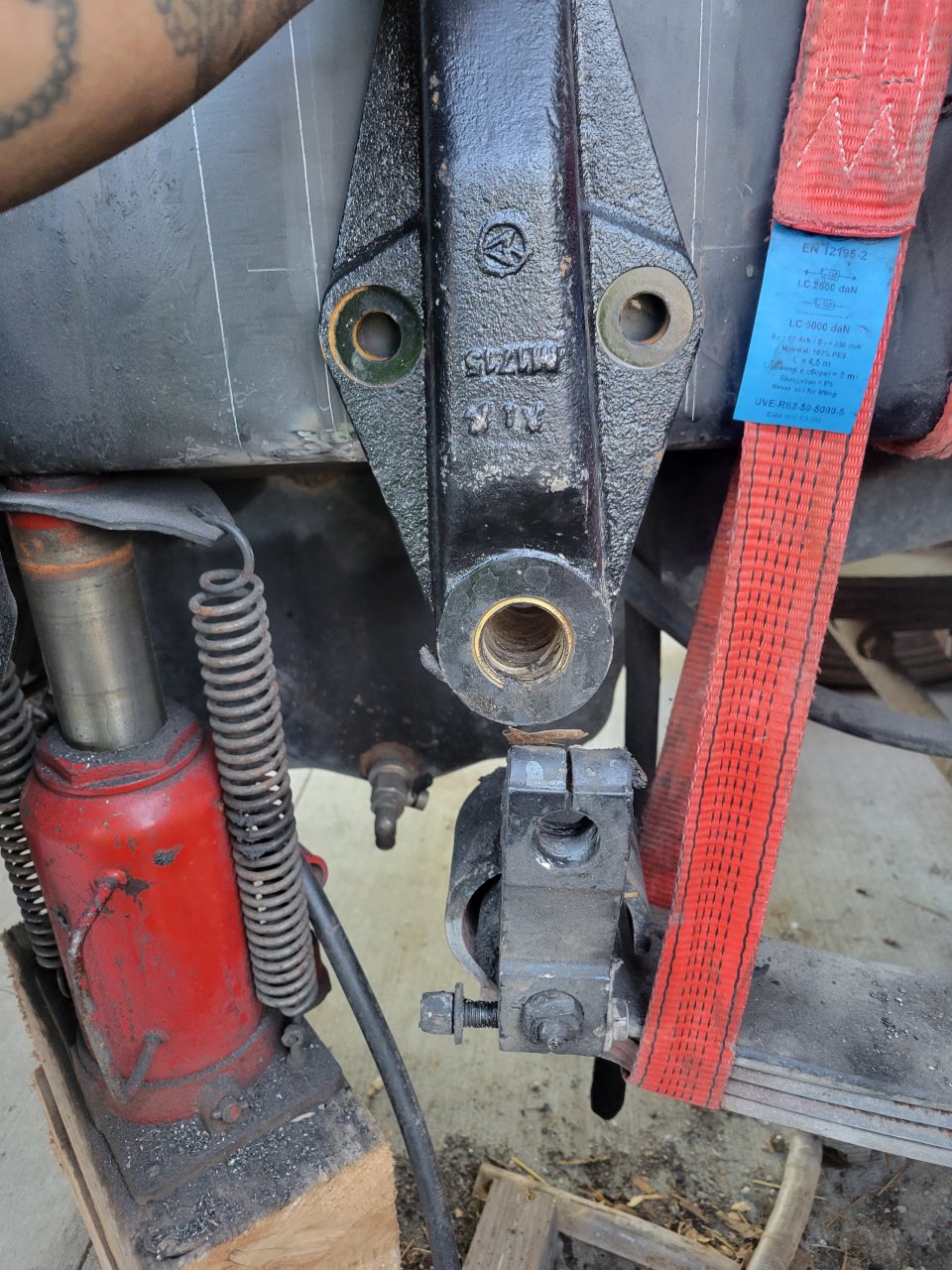

  10. irishluck09
    irishluck09 Light Load Member
    250
    128
    Nov 24, 2019
    Im currently changing out my old shackles with these new ones because of a cracked frame. Have you done it?
    What do you do to compensate for the distant to attach the hanger to the leaf?
    The new hanger sits higher than the OEM version. I know you can lift up the leaf more but that would throw off the camber.

  11. lester
    lester Midwest's #1 Feed Hauler
    2,862
    7,613
    Jan 2, 2012
    NW, Iowa
    longer shackles. my 15 W900 has really long shackles
