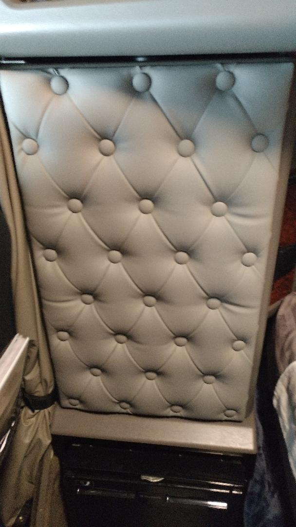

    Has anyone successfully removed their sleeper curtains on a W900L or even a T660 with the Aerocab? I never use them as I have full window coverings and it just opens up the cab so much more. curtain 1.jpg

    Should be relatively easy ...i looked at mine and thought same thing , but i dont have window coverings :)

    I wish it was easy.... you have to remove the closet hinge to remove the curtain

    I never even thought of looking there, it does seem like it's tucked in pretty well in the seams of the wall, I figured I was going to have to cut it neatly with a razor. Going to take a closer look now as I have no need for them at all.

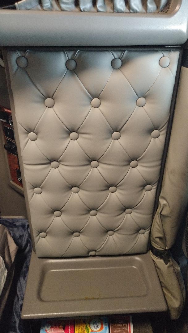

    My right and left sides are identical. So that top shelf/storage bin that you can see a little of in the pics needs to be unscrewed? How about down the sides where the cab and sleeper meet? Is that where those 8-9 screws are at? 500944-Z82.jpg 500944-Z83.jpg

    The shelf should only require removing the one screw that's in line with the curtain. The gusset that runs the length of the curtain is 1" - 1½" wide. And, yes, the screws should be evenly spaced top to bottom.
