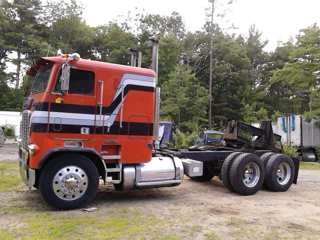

W900AOwner said: ↑Thanks to everyone for all the great information. After reading W9000AOwner's reply, I realized what I need: To be able to hook to the rear, raise it up, and not have to worry about pulling the drive shafts and fooling with the spring brakes, etc. Don't know what the heck I was thinking. SOOOO ideally, I could find a way to rent a ProTote, Big Ben or the like.Hey gltech,
Just thinking about this and if your bro-in-law is indeed a good fab-man, then how about considering having him build you a Big Ben 5th wheel rig like I got here...?
This one's a simple setup, made from a coupler plate, some box tube for the framework, and a 10" I beam for the lift beam. It has an old style drawbar off an old wrecker attached to the end of the box tube frame. Mechanism is 2 hydraulic rams that have about a 2' travel, powered by a snowplow pump/ 12V deal.
You hook 2 good, heavy 1/2" chains around the rear axles (chain up air suspension first of course,) and go to the drawbar. Another set of 1/2" chains go from the end of the lift beam down to the drawbar that do the lifting when you activate the pump. Works like magic. I towed a bunch of trucks with it, with this 81 Freightliner cabover in this picture.
This way, you don't have to go through the trouble of removing bumpers, dropping driveshafts or pulling axles...all you do is tie the steering wheel and cover the exhaust and rig the lightbar up, and head down the road.
