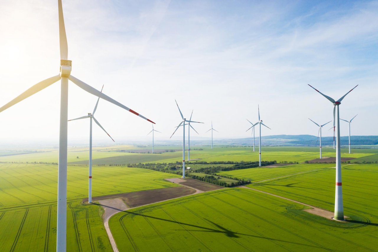

    Yes. Just like these things: zero petroleum, energy, metals, etc, used in the manufacturing. But, it’s “renewable”. :rolleyes:
