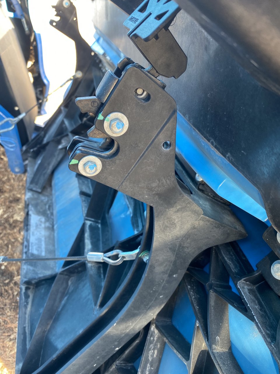

    Does the 680 have latches on the fairings under the cab? If they do you may want to make sure the bolts that mount the latches aren’t working loose. My project for tomorrow is putting Loctite on all the bolts on mine.

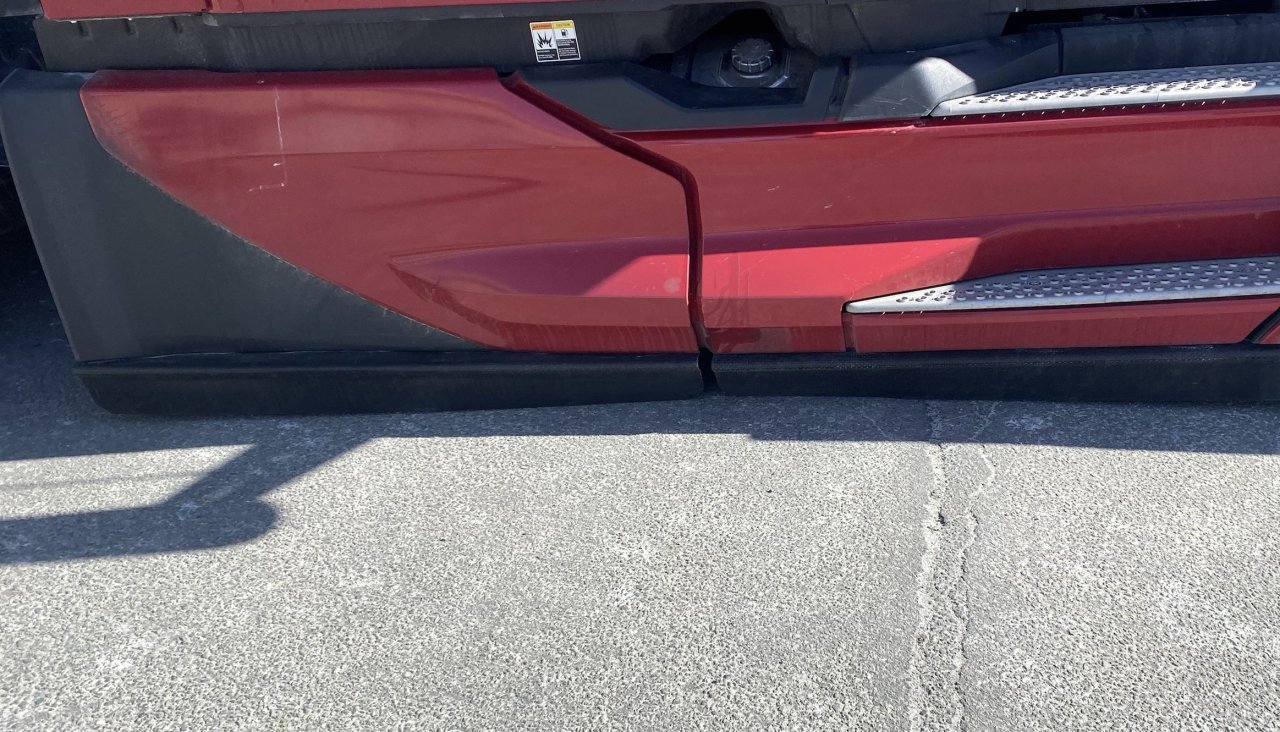

    Im not sure. Would you mind posting a couple pics tomorrow so I know what you mean exactly? Below the side piece or between the side piece and cab? Here’s a pic of those bottom aero jobs bending

    This is how the latches are on my 579. You can’t use a longer bolt with a nut because there’s not enough clearance. So I’m going to Loctite them all and see if that works better. Otherwise I’ll keep tightening them back up every few days. It’s a real stupid design.

    Did the far one lose a bolt?

    No. On every latch the top one threads in the opposite way from the bottom two. That’s some Peterbilt logic. Lol
