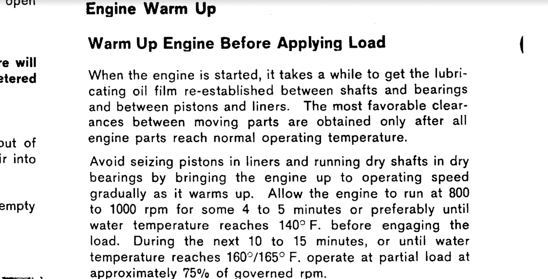

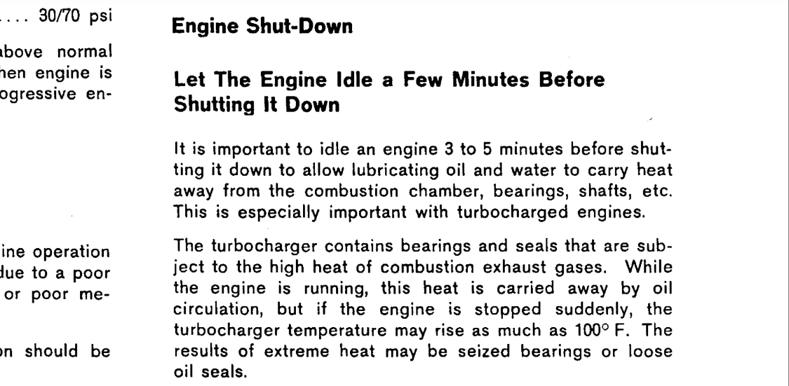

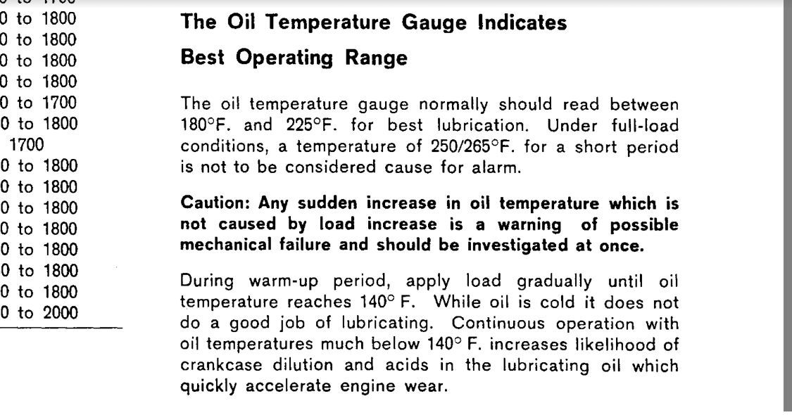

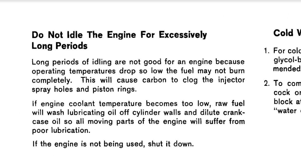

    Nothing has been much different over the years as far as procedure. This is from a 1951 Cummins NH operating manual that came with a DIamond T.
    Keep in mind that Oil pressure with straight 30wt. cold would be 80-100 psi and hot would be 45-65 at 500 rpm idle on those engines and they could idle all day long on a 100 degree day and not reach 140 degrees without the aid of radiator shutters.
