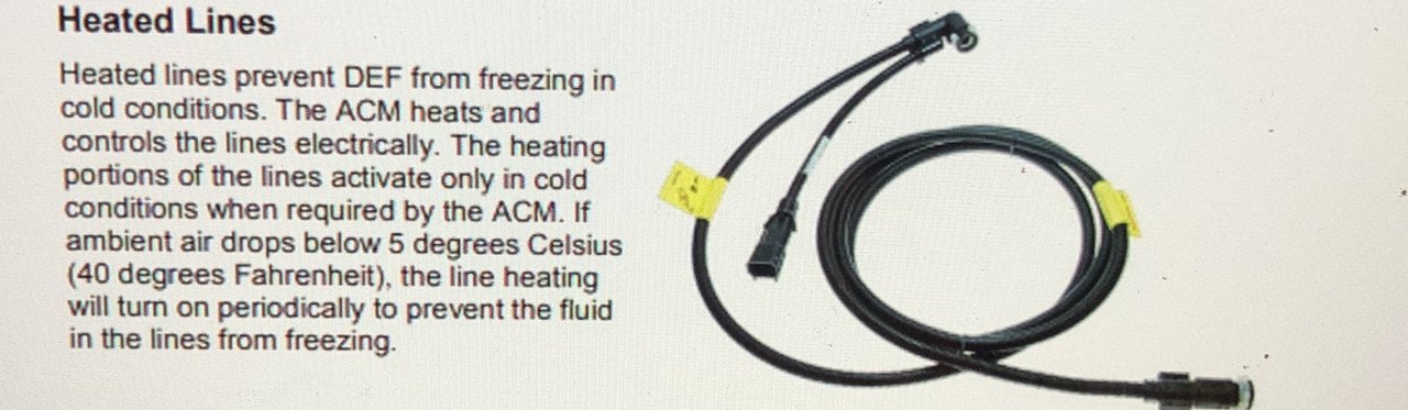

    This should explain
    D.Tibbitt Thanks this.

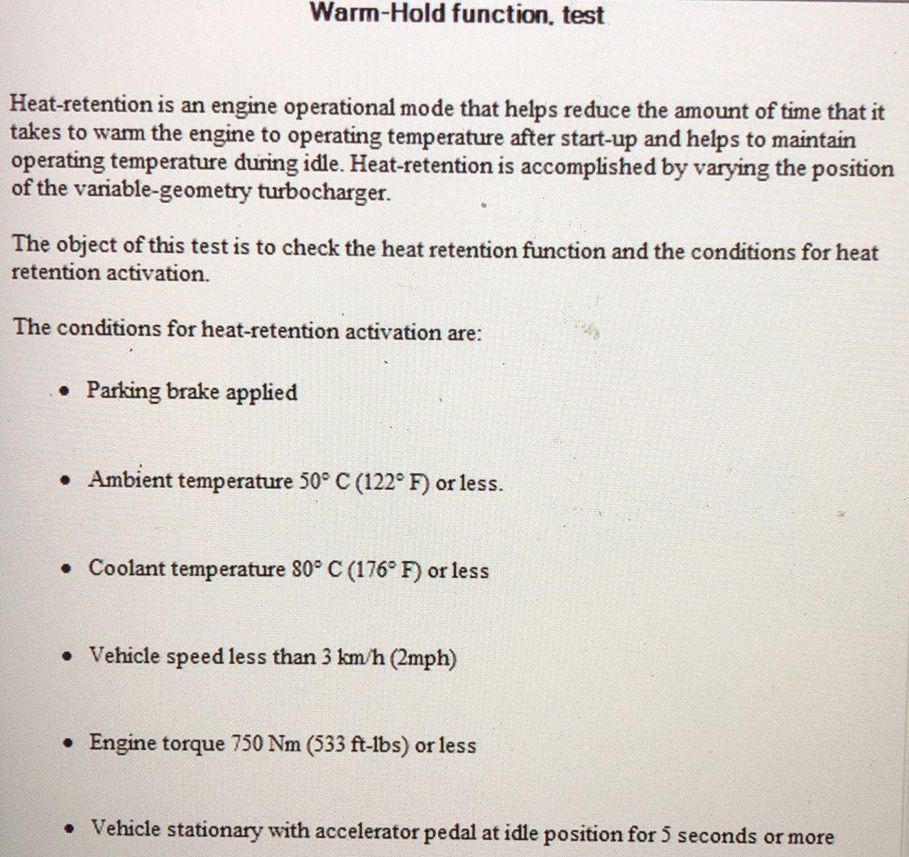

    Absolutely agree with you here’s two reasons why and where this ambient temperature sensor is used

    Maybe you should stop bashing people for expressing they own thoughts or opinions on here. You should just probably called that one person who actually knows about Volvo and get answers directly. But to answer your question: there’s a parameter you can change it’s called Outdoor temperature warning. It warns when exterior temperature is in the range -3C to +3C. Warns either each time or only once per driving cycle. And it’s programmable. Booya!!
    KB3MMX and bavarian Thank this.
