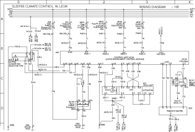

hey on the volvo the lecm control panel it what controls the webasto , temp, fan ,etc , it's possable that it is going out , i have been a volvo tech for dealer for over 10 years , go have it checked out
here is some info for the webasto
if your webasco is cutting off and on ,you need to check to make sure that there is not any thing blocking it , when they do that , that means it over heating , see attachments
