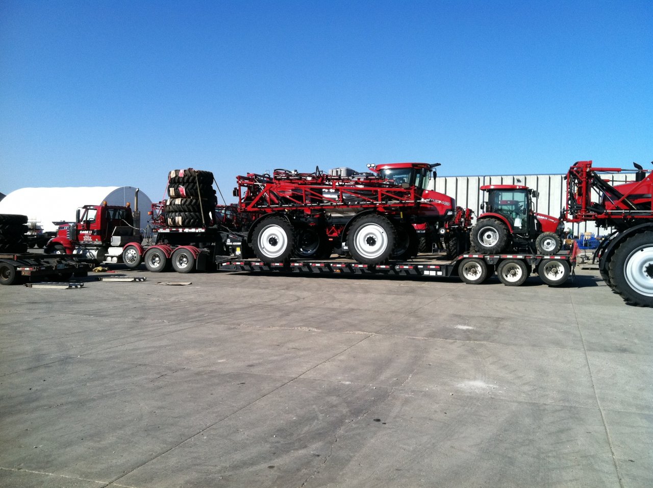

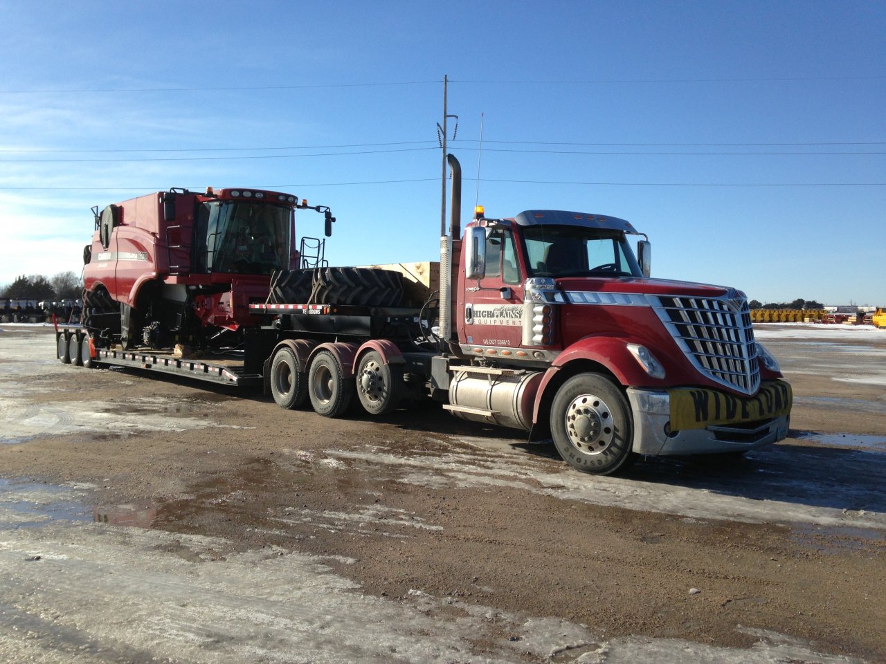

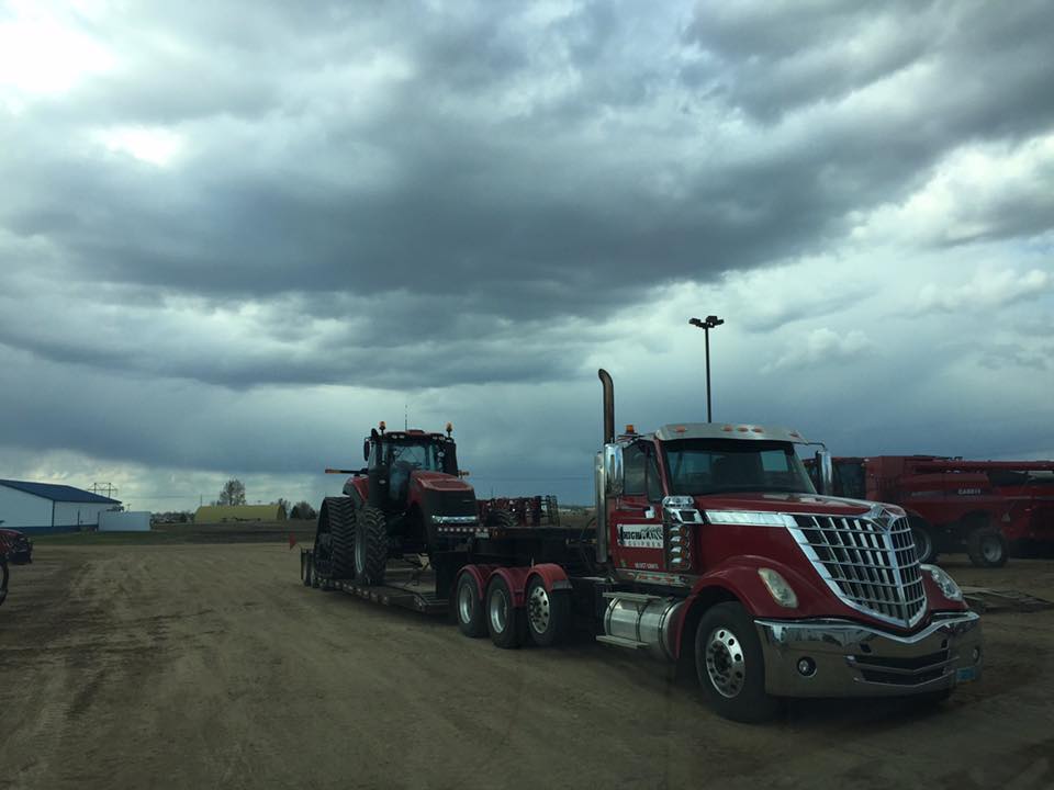

    The one with the issue is the quadtrac. But here are many different angles. The 4 axle trailer trail-eze photo is what i'm looking for, but will need more of a split in the axles and pullouts to make the bed 14' wide.

    Current Situation
    Optional but still will not work as im only allowed 48 on rear.
    This is more of what I am looking for
    Thanks for the reply!

    So what you're ideally looking for is an extra 500 lbs?????
    And what state/S or province are you hauling in?
    On the federal chart. For divisible loads. (pics you posted)
    Your 4axle spread of 15 feet is ideally good for 52, not 48.
    Your 4 axle spread of 17 feet is ideally good for 53,500. Not 68.
    And if you had a standard 4 axle trailer (say 53 ft. flatbed for instance). 52,500 on the trailer is what they haul

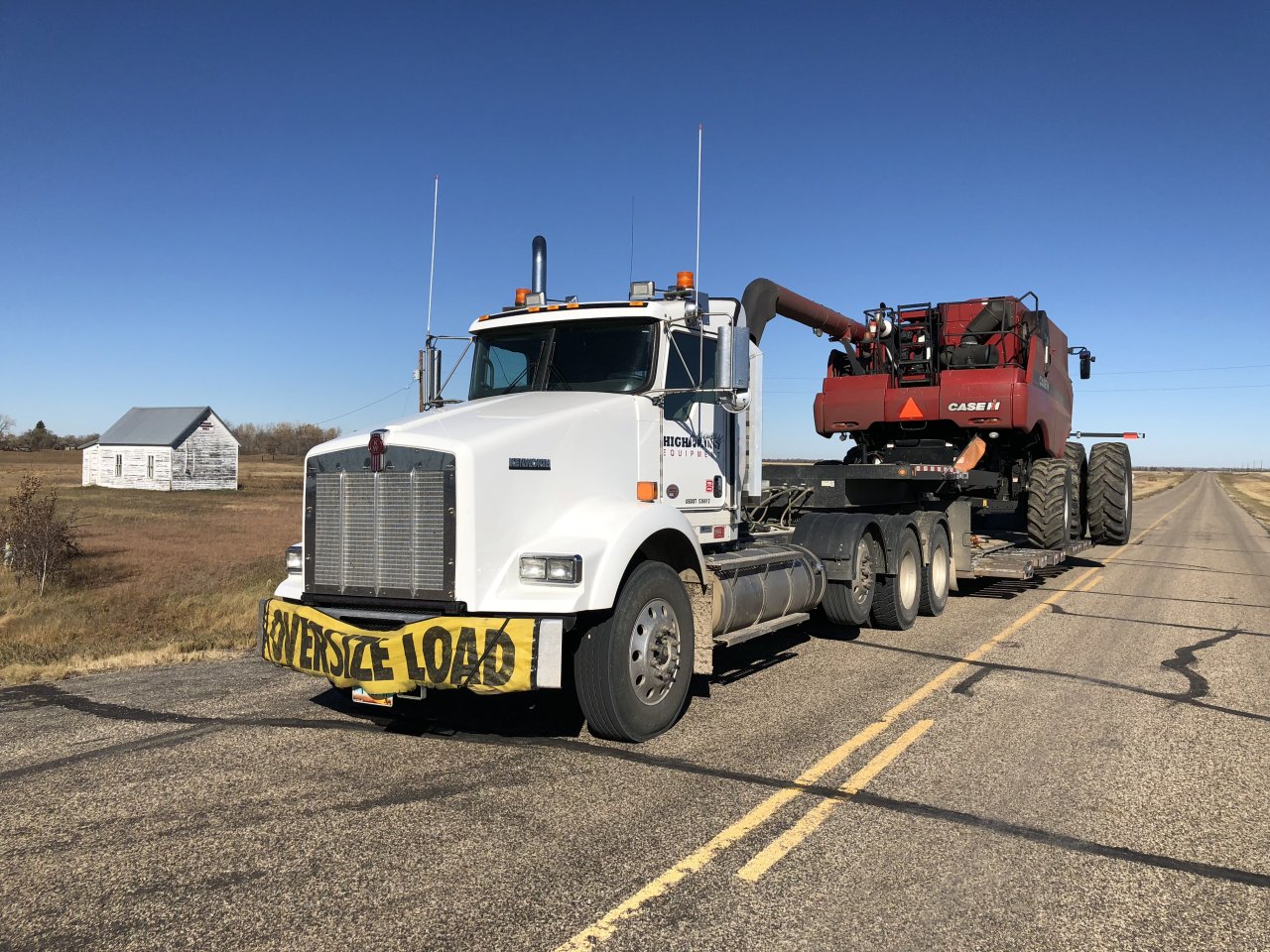

    Edited: I am hauling in ND, [​IMG] https://www.nd.gov/ndhp/sites/www/files/documents/Permits/Weight_Limitations_Chart_.pdf
    At 68' I am limited to 99,500. If I add 1 more foot to the bridge and add one more axle, I can get to 105,500. adding another axle to the trailers 3 grouping will only do me good if it is 8' away from the other axles. that will give me 20,000 more capacity on the trailer axles alone.
    In ND i can get an annual permit for 129,000. that would be more ideal being we have 300+ short hauls per year with this configuration. 129,000 Primary Network Permit – Annual | North Dakota State Highway Patrol
    The only time that I am running too heavy is with this.
    While Hauling this, I am 51,000 on the rear. I am unable to shift the weight forward because the detach is in the way. I am at 105,500 in this picture and the load is non-divisible.

    What about NON divisible permits????? According to the forum, would get you 20k per axle. 60k for your group of axles.
    Again, depends on ND.
    Google shows NON but I'm only getting links for single trips.
