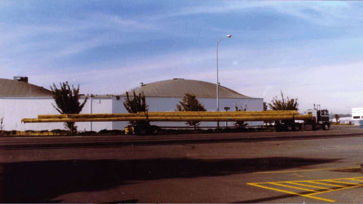

    I'm looking at your photo here with that super long load,is that what you haul?I seen a driver today hauled some farm equipment and the load was twice as long.Never have I seen a load that long till today.He made huling those wind towers looks like anormal load.

    I have driven OD trucks for since 1987. That Pipe truck(Stringer Truck)I have driven since 1992. I now drive a RGN for the most part. There are many types of OD "specific" types of trucks. Long load trucks/trailers depend on what type of load and what kind of terrain. Here is another type of long load truck I drove. It's a Truck flatbed with a Log trailer in tow. This a closer view of a Stringer truck from last year in CA. And now back to our regular schedule.
