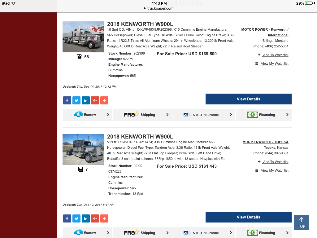

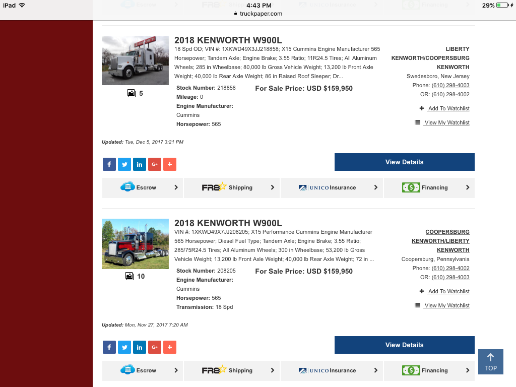

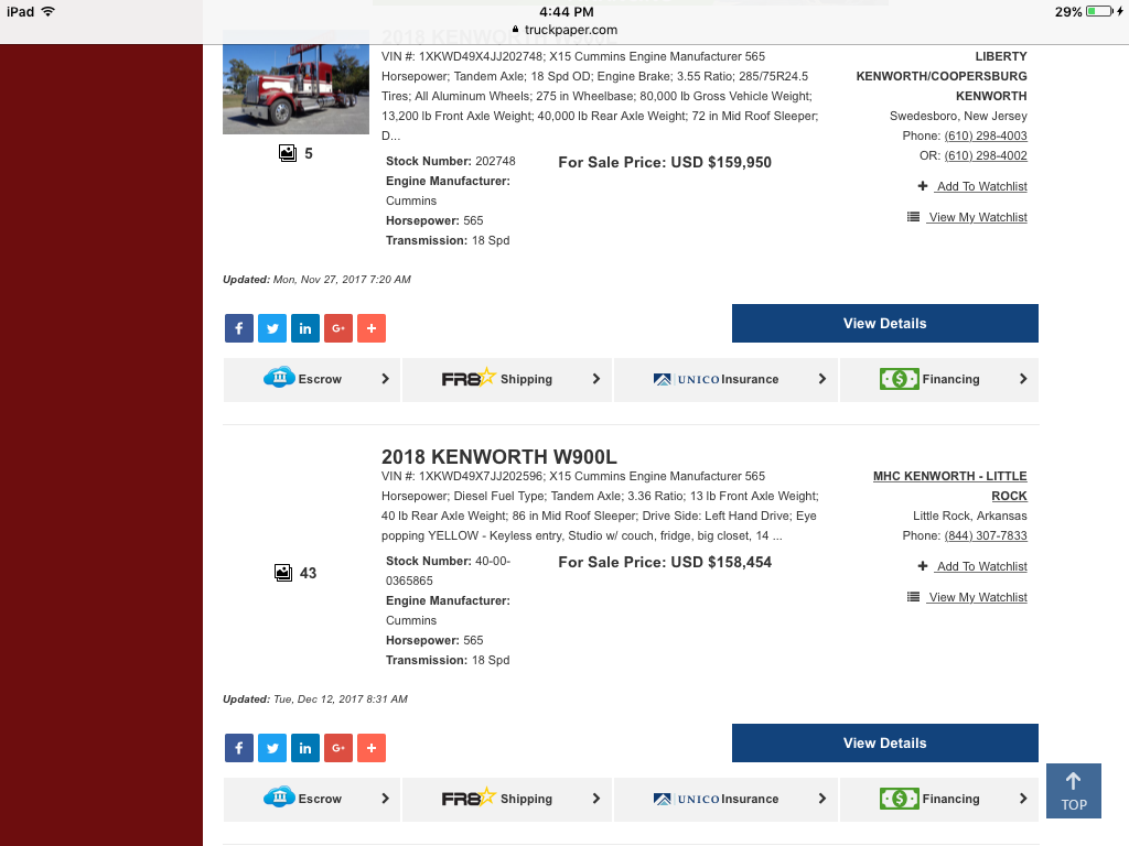

  11. Banker
    Banker Road Train Member
    4,597
    15,353
    Aug 19, 2012
    Quick search of W9's on the truck paper shows front axles at 13,200. My point was to let those who thought all OTR trucks were still legally only allowed to carry 12,000lbs up front, check their individual truck. Maybe they may be allowed to carry more on their rig. image.png image.png image.png
    Hammer166 Thanks this.
