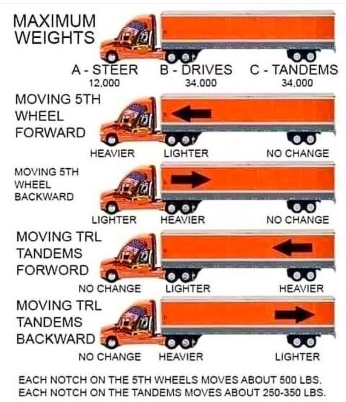

  10. Random truck guy
    Random truck guy Bobtail Member
    13
    3
    Nov 6, 2018
    Bummer I'm late to the party. :D.
    @otterinthewater , one I love the forum name. And two. I live the pic you posted, I'll be narrowing that ;)
    @OP. Its been awnsered in a few posts.
    But anyhow. If your on the inter-state max weight ok n a steer axle would be 20k, or max weight your steer tires are rated for. Which ever is lower.
    Weight bonus for external APUs in my experiance range from 350 to 500lbs depending on the state. And will only help with weight on the drive axles. (Axles 2/3) to my understanding it won't help with your steers or gross. Though I could be wrong.
