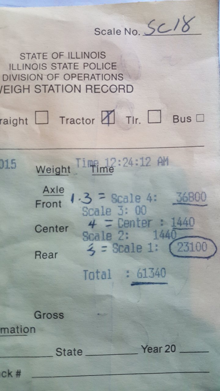

    I get overweight ticket on the scale. Total weight was 61340lbs, load weight 27400lbs I had 24 palettes. I did slide my tandems on fourth hole. They found overweight on the trailer axle. I don't know what to do now?! This is a weight station record...

    Slide the tandems on the trailer BACK further to move some of the weight on the drives. I cannot see the posted image

    That guy that that picked you up,you should have asked him to explain the weights.just because the weight is on the Qualcomm and bills does not mean your legal.the shipper does not distribute every load evenly.why do you think there's scale houses.also that ticket your company got,dont be surprises if they take money from your check to pay for it.it is your job and responsibility to male sure you are legal not your company.

    I can't understand that weight receit

    If we could see the other half of the document it might shed some light on the subject.
