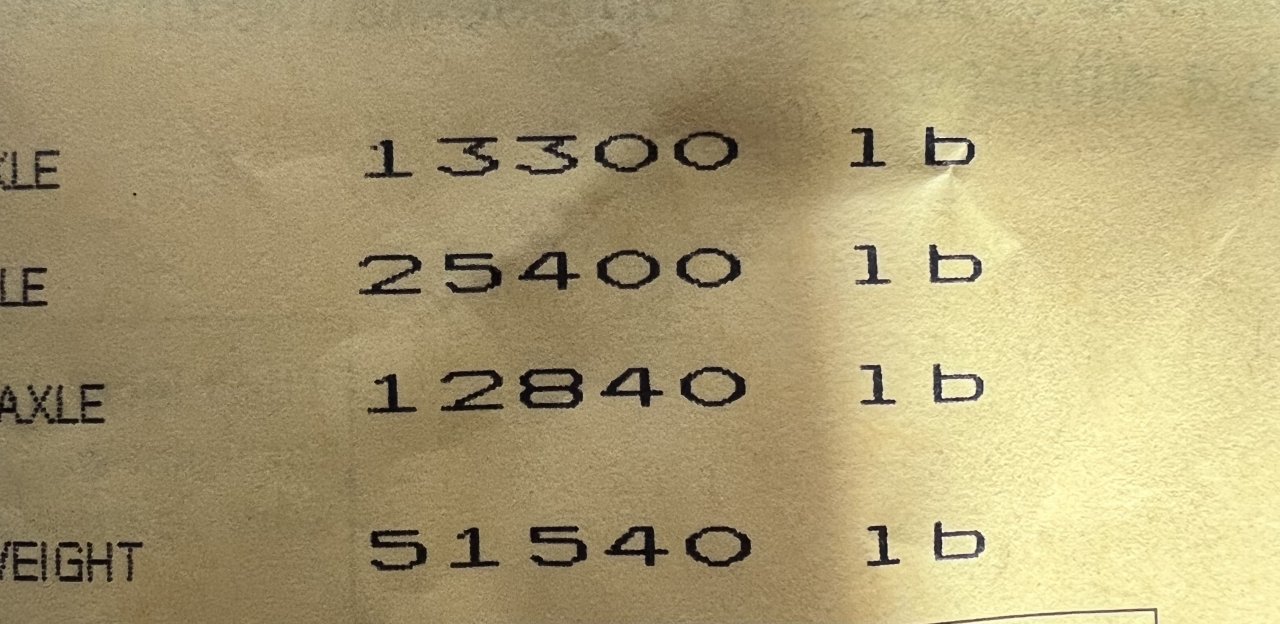

    I think a lot of trucks are being ordered with heavier front axles and the scale guy would physically have to come out and look at what you have
    Car haulers. Big bunks etc all have heavy specs
    My ticket is a big bunk with 14k in the nose of my trailer
    Only thing I’ve ever seen a scale do is look to see if I had the correct steer tires for my weight. Which I do have a wider float type tire and they e just glanced at them from their desk
    I think your good probably to 14k in most scenarios but I’m much heavier and doubt you’d get there anyway
