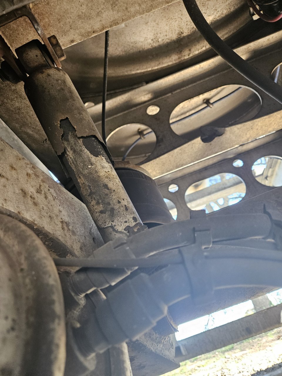

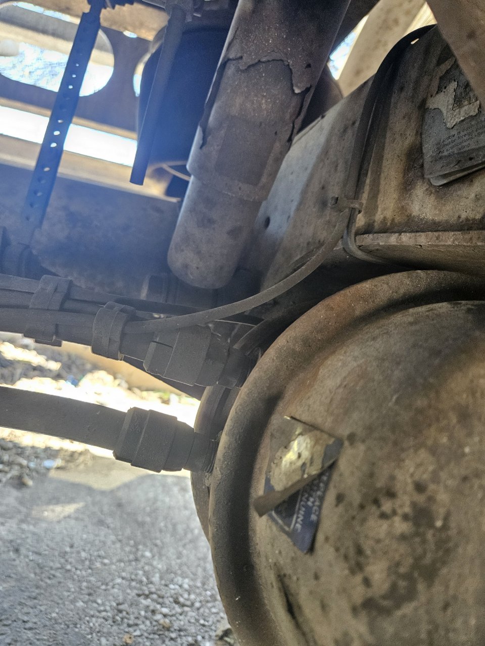

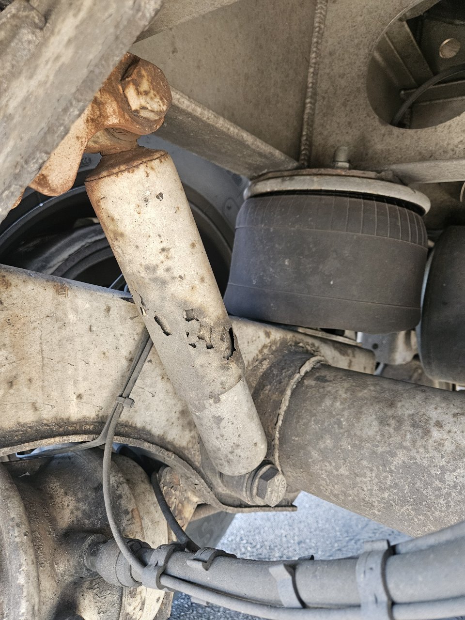

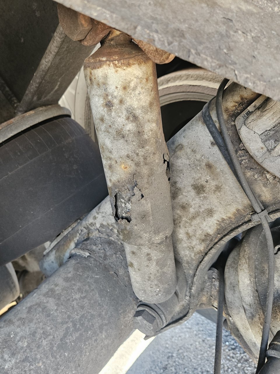

    So... I stopped at a Truck stop, dropped the trailer and do some inspections and look what I found, this is all four of them btw, I forgot what they are called but that's on the trailer btw, any thought on this? I took a better picture of one of the tires. ( Drive axle )

  10. Diesel Dave
    9,781
    33,793
    Jan 20, 2010
    Hesperia, Ca.
    I’ve driven loaded trailers with bad “Shocks” and never experienced your issue. Also, trailers with new tires, no issues neither.

  11. nextgentrucker
    nextgentrucker Road Train Member
    1,702
    1,622
    Sep 25, 2023
    Port Saint Lucie, Fl
    I honestly hope you're wrong about this LMFAO!! I hope it's a trailer issue and not a truck issue because I can't put up with that for weeks, I'd go insane...
    The new tires are on the truck, it's probably what @Long FLD is saying but I'm hoping it's not, I'll drop that load off tomorrow and pick up an empty tank, I'll update you guys on how it goes.
