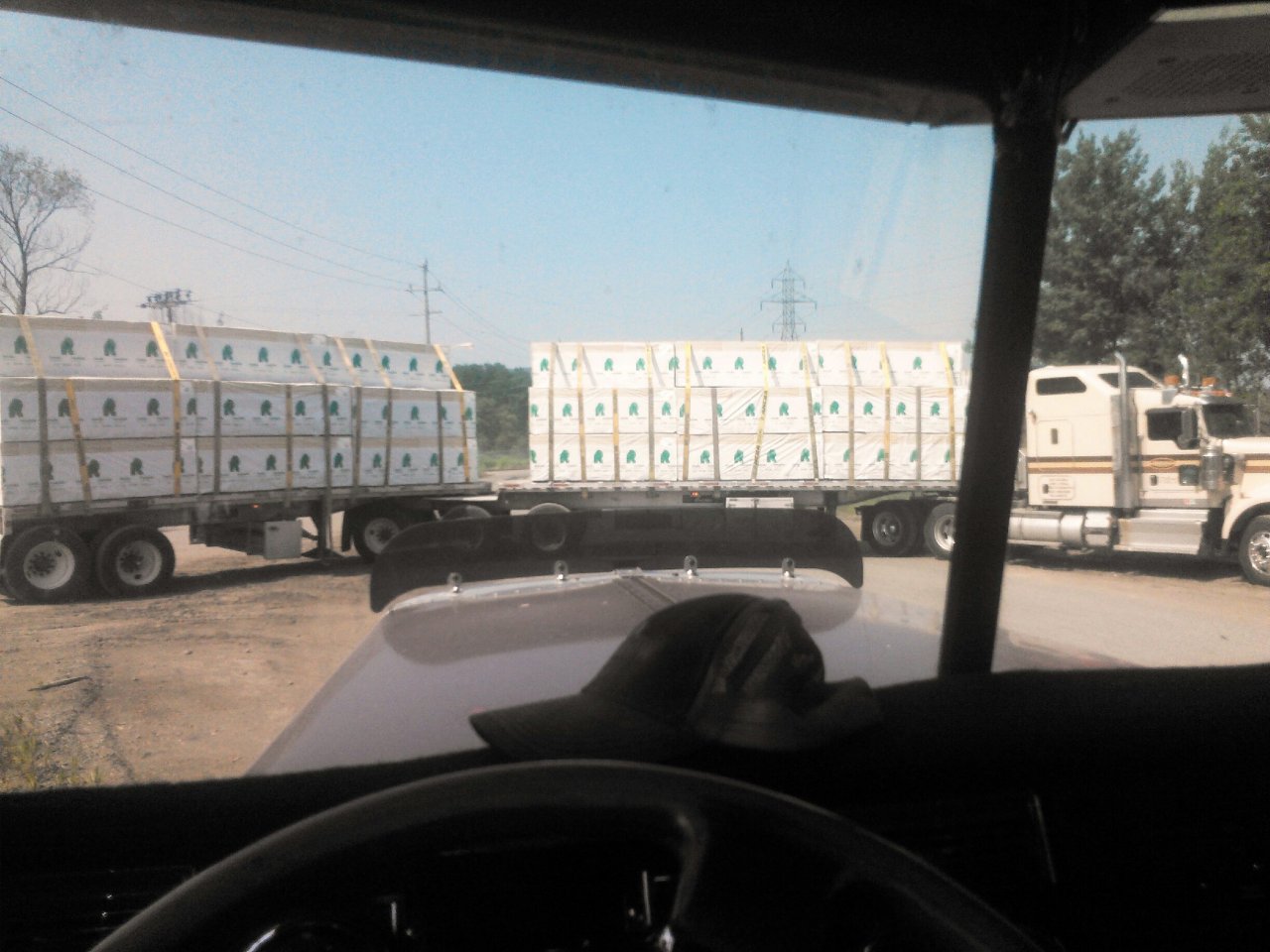

    It just boggles my mind to see a train like this that is legal in most if not all of Canada. f7.jpg
    Its perfectly legal to haul massive weight on a tri axle, but take that center out and make it a spread and only good for 20,000# total on the trailer? And my massive, huge, can't turn a corner, unrealistically long 260" wheelbase truck couldn't possibly pull a 53' trailer. Or keep from killing everyone nearby unless my trailer wheelbase is 40' 3" Somehow it always feels like the deck is stacked against a guy. Thanks for your reply's fellas. One way or another I will get geared up properly, if only for the fact that it seems the government is intent on keeping me out.
