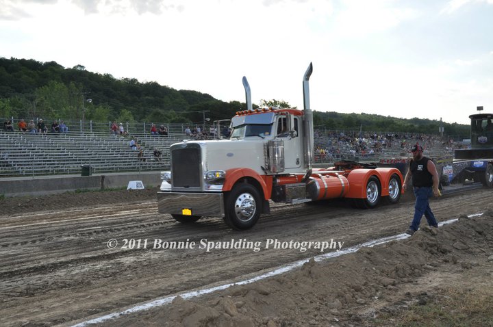

my rigAttached Files:
The clutch started out as a standard Lipe unit that has been machined for bigger springs and thourghly checked over by a guy in PA that builds these clutches for sled pullers. It has 6000 lbs of plate load and is actually pretty decent for pedal effort in my 379 Pete. The fuel pump is shimmed to bring my fuel PSI up to 105 PSI at 1400 RPM. This is a different setting than what many guys use, but it fits my operation perfectly since I never run the motor over 1400 RPM in daily use. When I pull I just take one shim out of the pump to drop the pressure enough so the motor will rev to 2100 RPM without pushing fuel past the injector o-rings. If you want to know how to shim the pump do a search for it. It is explained in at least 5 different threads here that I know if

I see, was that Joe Ritchey who did that clutch?... Rigwrench nice lookin truck!.... Ok Lenny i appreciate the input

How is tha for everday use? stop and go?
