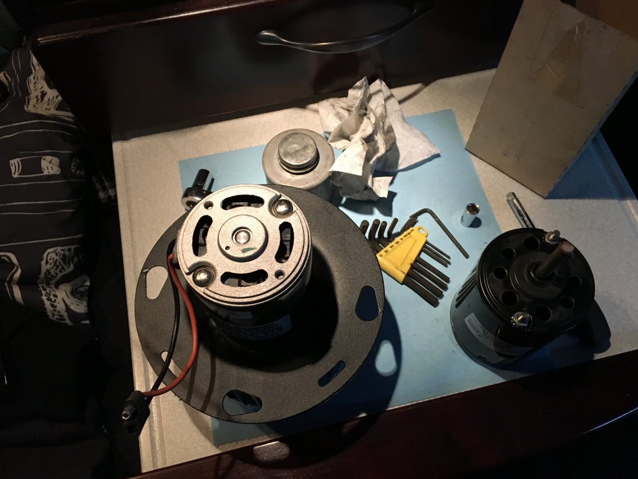

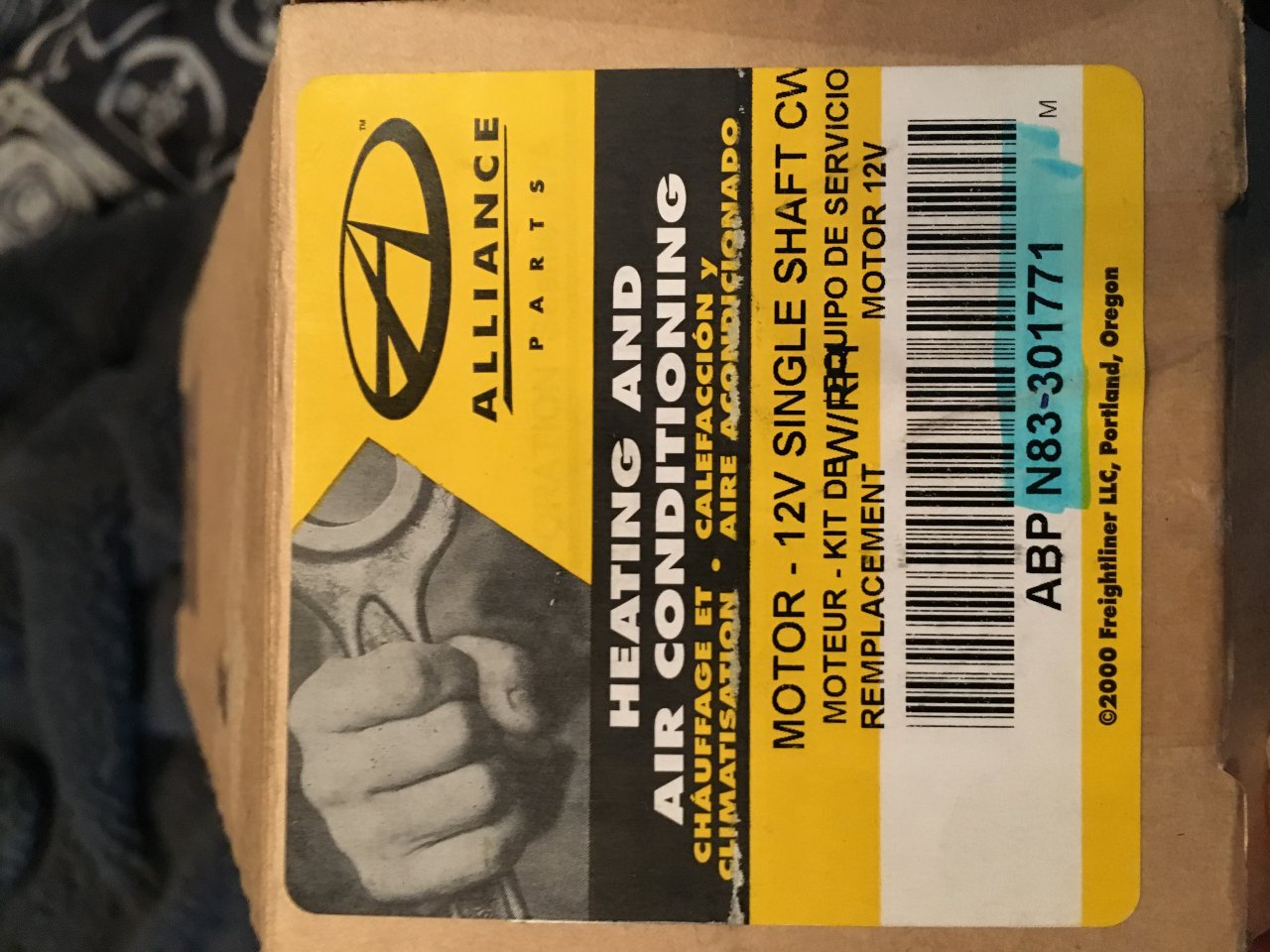

    The fan motor was getting louder and at one point quit completely on the last trip. That got my attention quickly when heading North in BC. Unfortunately, Nadina truck did not stock one, but James Western Star in Prince George had the whole assembly or just the motor. I figured since the truck is less than two years old it should come apart and opted to buy the motor.
    The motor made it all the way North where I replaced it since the noise was getting on my nerves. Here is the part number for just the motor.
    I am sure glad the truck comes with a shop and workbench in the sleeper.
    Cetane+ Thanks this.
