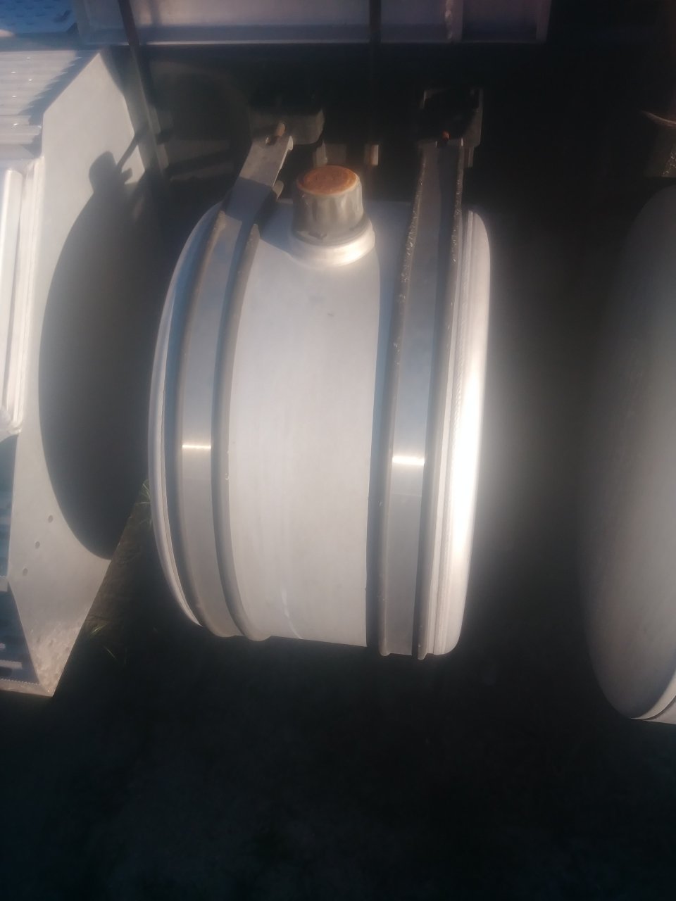

    How big is the hyd oil tank... ?
    The psi is probably a little high but would be ok as long as you don’t top out the piston and keep pumping oil.... That’s real hard on seals.

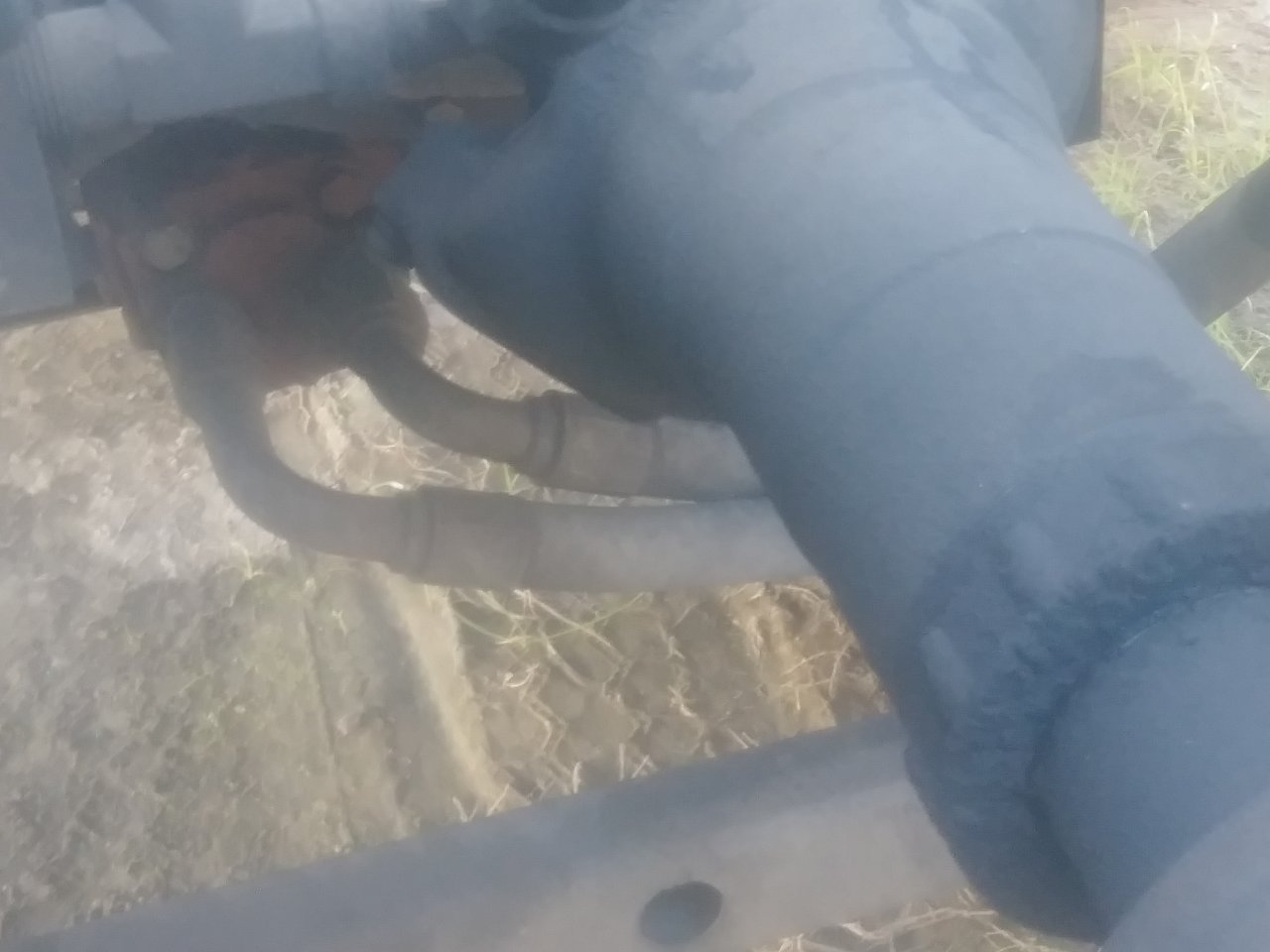

    The thing about the end dump pump is the valve to engage the pump is mounted to the pump. It bolts right to the PTO itself. Our walking floors use a gear pump that just has an in and out line that hooks to the trailer controls. I am almost sure that pressure and flow requirements are too far off to run both dependably as needed. That isn't saying it can't be plumed up and made to work for a while

    My oil tank is like 30 gallons maybe a little more

    Depends on which style PTO you have. There are different ratios as well. Without seeing what you have it's hard to give that advice. I have run plenty of used ones, a bearing kit isn't expensive or hard to do.
