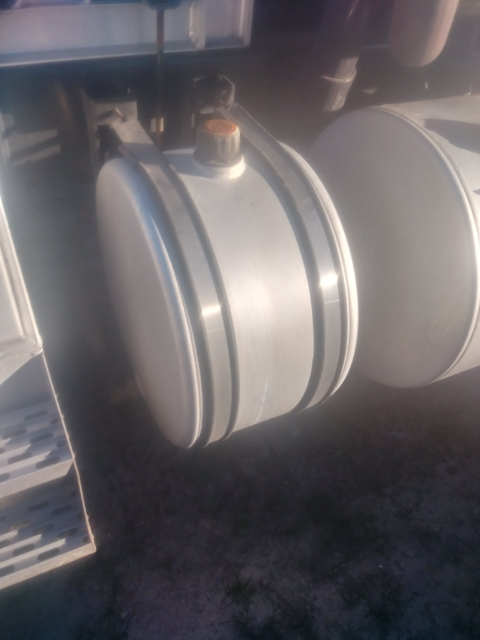

    Would i have trouble finding the hoses and the rest of the parts? Do they need to match the pump and all or can i buy the components offline n fit right on?

    Go to a truck body dealer see what new cost in your area. The 750 may be a bargain.
    Don't take this wrong but till you get familiar with the set up I wouldn't buy anything online. It's easy to get a pig in the poke.

    Need To find out how much oil your trailer takes.... a 28’ dump with a regular hyd ram you might be alright. I’ve used some trailers that take 50 ish gallons to get all the way up.

    I thought that was considered a “single line”? Only one line running to the trailer. I thought a “2 line” wet kit had 2 lines running the trailer itself. Pressure up and pressure down. Single lines just provide pressure up and gravity brings it down. For example end dump trailers. Correct and school me here.

    Correct, a dump trailer needs a single line, walking floor needs a 2-line, pressure and return. I have a 2-line set at 2800 psi, runs a dump and walking floor just fine. Don’t want to bottom the dump cylinder out though….
