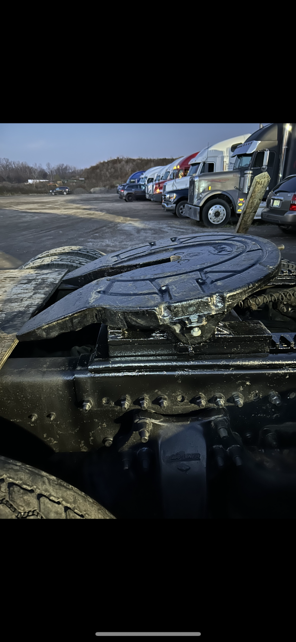

    21AD6A8A-A09F-454D-B625-0DBD2F6C48E3.png Guess I’m the only Holland fan. Always heard they were the best. Just replaced the original on my 2001. Same Holland. Brand new not rebuilt. Paid $800 from a Guy who buys TruckLoads of surplus items. He had other brands too. One Fontaine with a double length slider set up. Not sure what that’s good for. Hollands heavy. Looking at rebuild kits, and instructions on all 3 brands convinced me that Holland is the best. Simple design and fool proof mechanicals compared to the others. Good for another 20 years. They’re probably all good. Just rather stick with what has always worked in the past.
