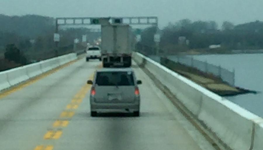

  5. MACK E-6
    50,560
    243,934
    A little blurry, but this is the worst case of that I've ever seen.
