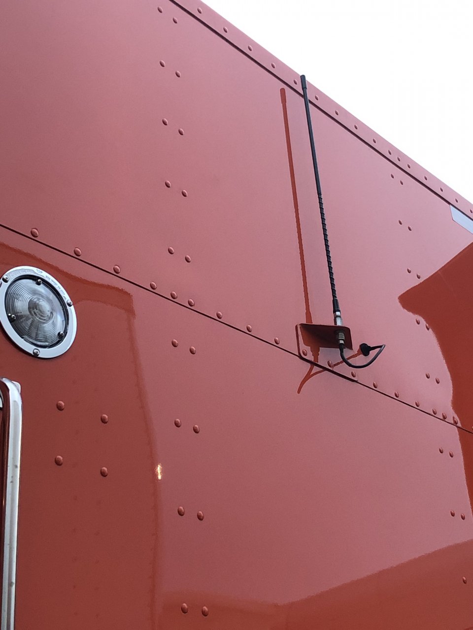

    Best CB antenna setup I’ve ever had..after one year still doing great. Radio and antenna are factory installed. 5F66096A-2E2E-42B7-BA31-C3D80E771042.jpeg
    Although one annoying issue. Every time I use the windshield washer the CB goes crazy with almost like the sound of the washer motor.
    My knowledge of CB’s and troubleshooting is nonexistent..just an out of the box type of driver.

    That’s not high enough, it doesn’t clear the cab. No signal to the front. The broker I haul for has a similar set up on there new truck. The guy couldn’t get out. I told him to get an antenna that clears the top roof. He did and now he’s a happy camper.

    How much higher would you say?

    Long enough just so it clears the cab on top. Measure the one you have and just add whatever more you need to clear it. Mine is a mirror mount and it’s over 14’ , I’ve never had issues at the scales for height as some have mentioned on here. Add a good quality spring on the bottom mount if your worried about hitting trees or low over passes.

    Okay, I’m going to give it a try. Maybe it’ll motivate me to finally swap out the radio with a better one I have sitting at home. Just a Cobra but has the weather band on it.
