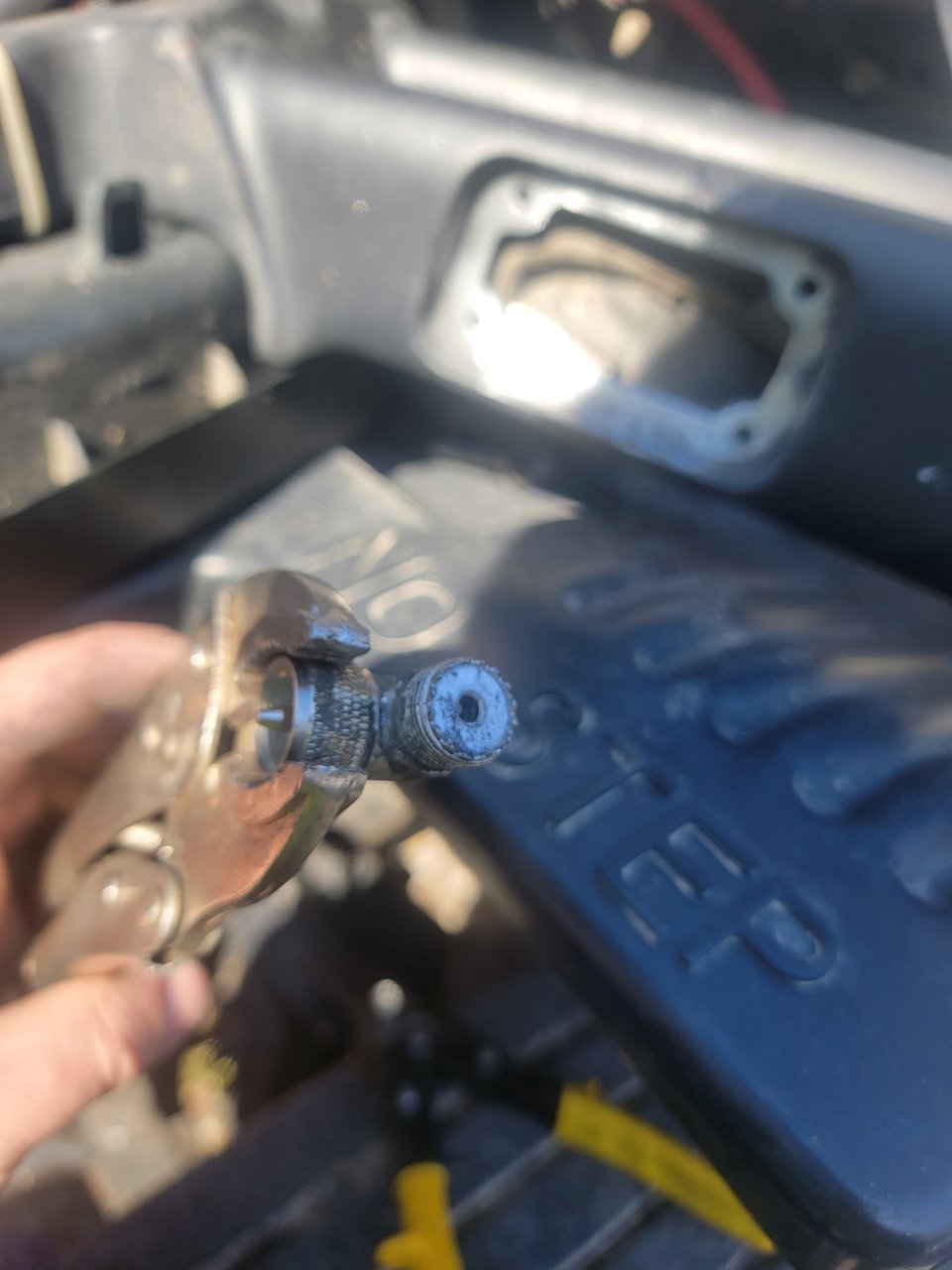

    Bentonville Arkansas
  8. Diesel Dave
    9,748
    33,456
    Jan 20, 2010
    Hesperia, Ca.
    No, I have one in my set up to keep from bending the coax at the end. Had it for Decades.
    Edit:
    Let me clarify this, I’ve use it right off the back of the radio which of course would be inside the cab. I have no idea what it would do outside.
    Reason for edit: Edit: add more to my post

    I had a heat sink clamp tool like this one...
    GC 9077-1 Heat Sink Clamp Tool - 0.67" - Soldering Aid - FREE SHIPPING | eBay
    I would clamp it on the center pin of the pl 259 and the clamp tool would absorb the heat from the soldering iron and protect the pl 259 connector, and then crimp the ground shield. I had bought it many years ago from radio shack, but I lost it. I haven't been able to remember what this tool was called, but now that I found it on flee bay, I better order it again. Thanks Mike for your post to remind me about this great tool.
    mike5511 Thanks this.

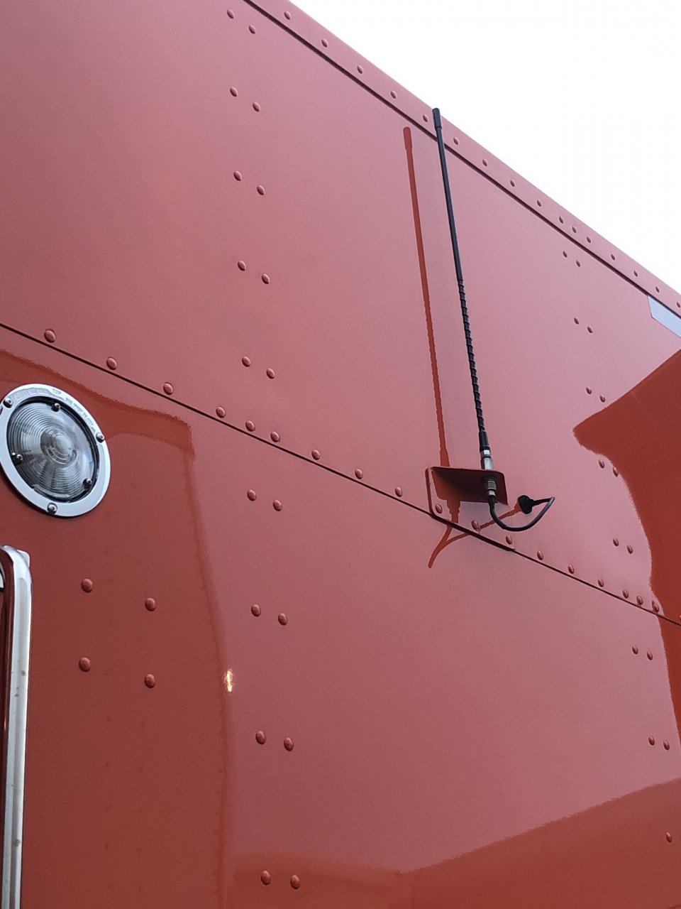

    Jun 26, 2017
    When I first read your post, I thought you were joking. They recommend at least 2/3 of the antenna to be above any metal object, such as the back of the cab in your picture. It would be best for you to buy a top loaded antenna.
    Diesel Dave and Concorde Thank this.

    Jun 26, 2017
    Some people say yes and others say no. I used one for years on my cobra cam 89 base station back in the 70's with no problem. Of course it was indoors out of the weather. On my outside connectors I use a jar of black rubber liquid tape. I buy it at Wally world. Don't use the brush that comes with it, or you'll get it it all over everything. I use a q-tip and apply a small amount around the seams of the connector where water may enter. Works great.
