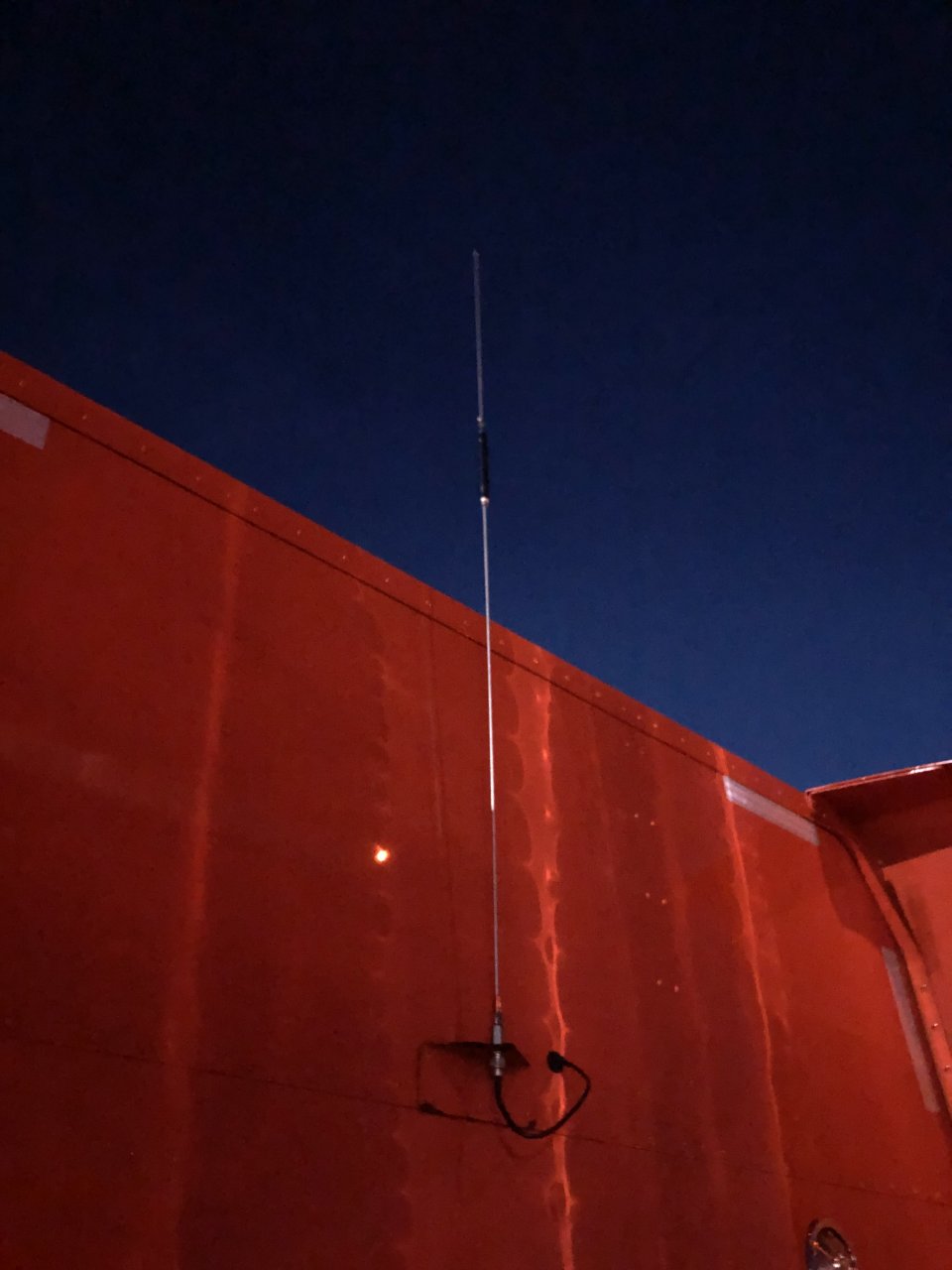

    Eleven months later I finally did it! Amazing how much I’m picking up now with the new Antenna. It’s a Hustler metal mid-loader. This one is 4’ so it’s 2 feet above the sleeper. Got it at the Knoxville West TA CB shop. Pricy $73.56 IMG_4774.jpeg but what isn’t these days
    I really didn’t want a fiberglass one because I was constantly breaking them clean off. They would load up with ice and stay swaying back and forth until they snapped. This new one I can see already is going to be hitting the top corner of the sleeper so I got to figure something out..maybe a small piece of foam..
    Kind of kicking myself for not doing it earlier but that’s my ignorance.

  10. craig_sez
    craig_sez Road Train Member
    5,570
    2,714
    Sep 5, 2013
    novascotia,Canada
    Try finding a short piece of pvc just barely big enough in diameter to fit over about a foot to stabilize it some more..
    Did the very same with a 7ft skip shooter and my 102 on a riser..Worked perfectly..

  11. Diesel Dave
    9,781
    33,794
    Jan 20, 2010
    Hesperia, Ca.
    Poke a hole on a tennis ball. A hole small enough where it barely slides on the shaft.
