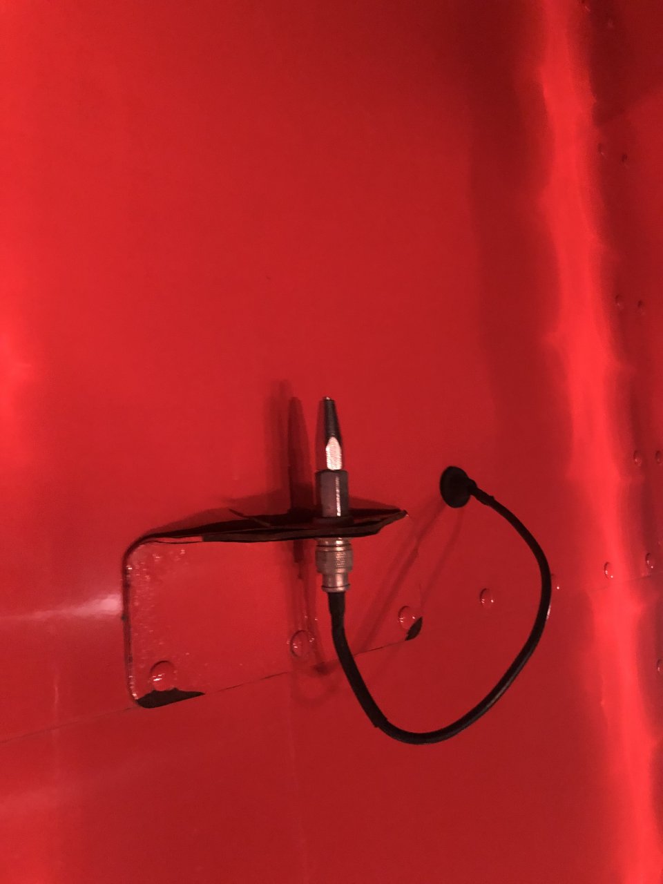

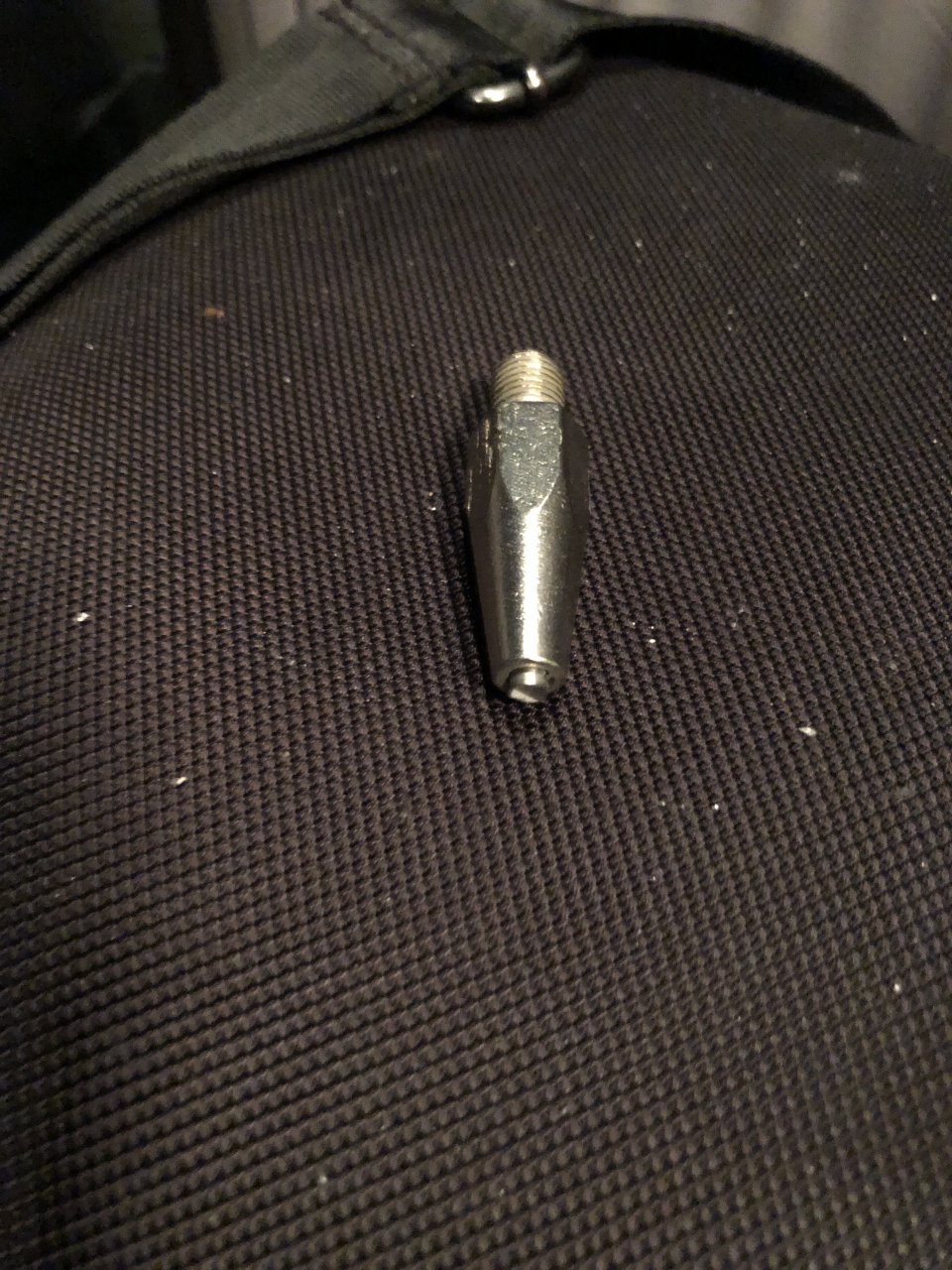

    Well that antenna didn’t work out well..snapped right off at the base. Another $75 down the drain. Fiberglass antennas don’t last either, soon as they get ice buildup they snap right off.
    Amazingly it still worked, lol.

    Do tell what name brand it was …..

    Hustler mid loader.

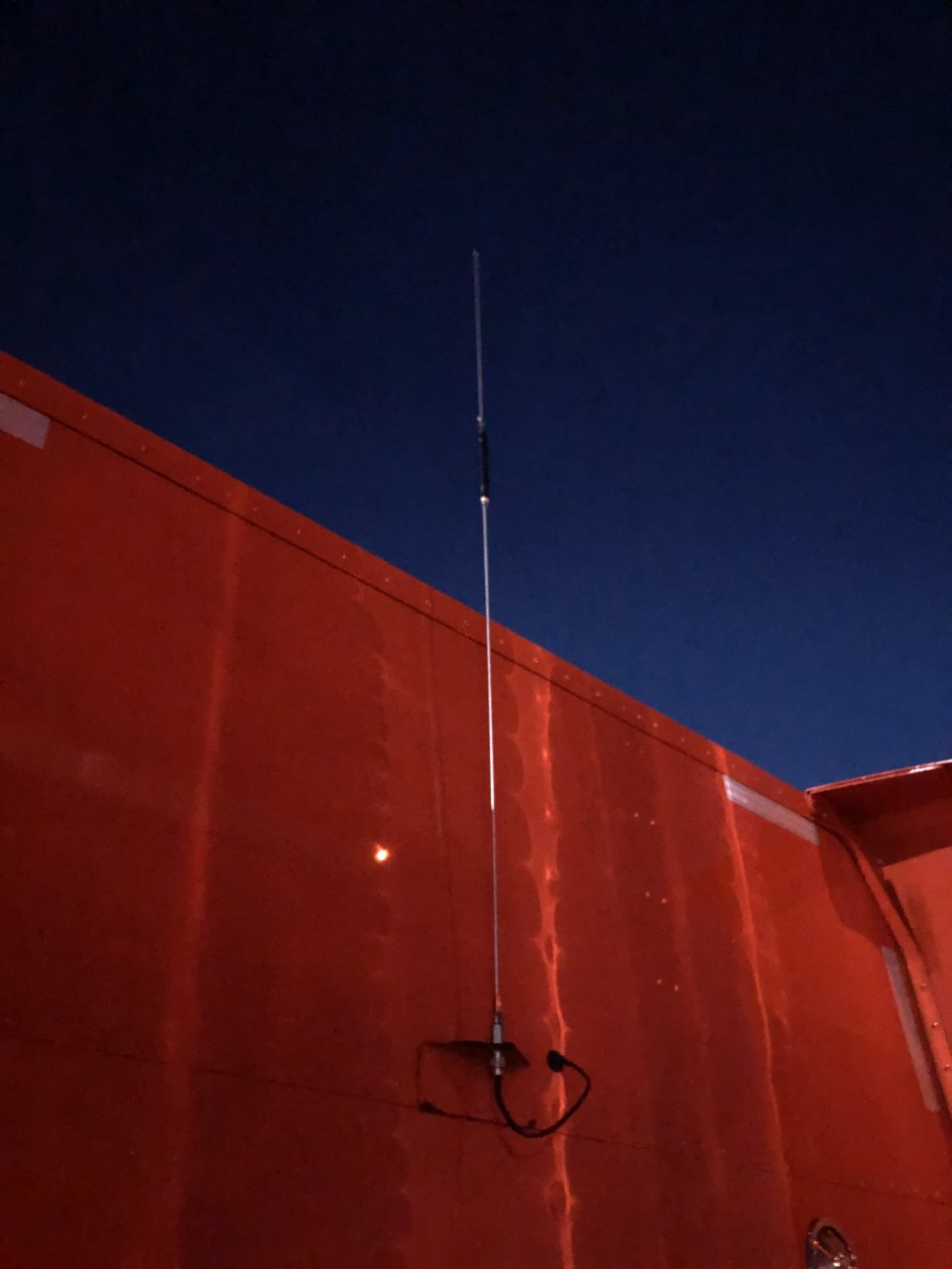

    No spring ? I scrolled back and found what probably is/was the antenna in question?

    If you scrolled back some, I recommended you to add a quality spring. Sorry about the loss.

    Yes, it was this antenna..spring? No.
    Recently ran across NE @ 75mph with a 35 mph headwind which probably didn’t help in its failure. What’s strange is that I didn’t notice any performance issues with my CB..just noticed today that the antenna was gone!
