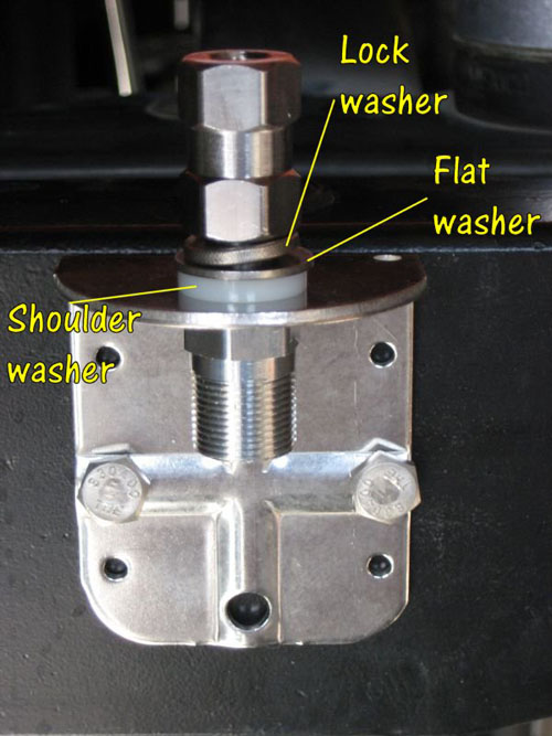

    Well...I finally managed to figure it out. After grounding everything really well with flat-braid straps, I still had the issue.
    Upper-spec'd ProStars have those pretty chrome-plated covers over the brackets where the mirror arms mount to the door. The upper one is quite large... and of course they're chrome plated, so it's a metal film over plastic...
    Bonding this cover to the mirror arm with a short (2.5") length of flat-braid dropped the SWR down to 1.1-1.2 with my Barjan T-II mounted.
