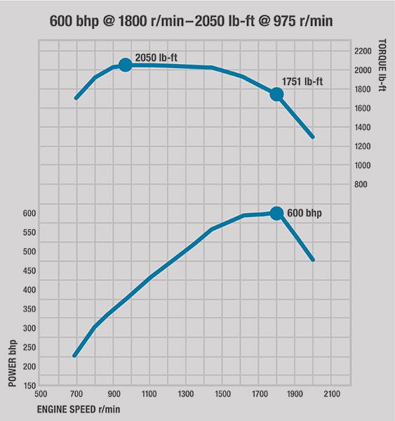

    Using your graph, how did you arrive at an overlap/intersection point of 1600 rpm?

  5. Jubal Early Times
    3,069
    20,586
    Oct 17, 2022
    I reckon it’s probably closer to 1500.

  7. gekko1323
    gekko1323 Road Train Member
    1,700
    2,839
    Jul 14, 2018
    Henderson, NV
    Nice. How is it spec'd with the hp and rr? What kind of mpg are you getting?
  8. gekko1323
    1,700
    2,839
    Jul 14, 2018
    Henderson, NV
    I wasn't questioning your accuracy. I was just wondering how you figure it out. My graph is posted on this thread also and I wanted to figure out what my sweet spot was.

  9. Jubal Early Times
    3,069
    20,586
    Oct 17, 2022
    It would be easier if you could overlay the two. But if you look at mine peak torque is at 975 rpm’s with a fairly flat curve all the way out to 1450 and just begins to really fall off at 1500. But horsepower is climbing pretty steep from around 350 at 975 to 575 at 1500. So at around 1500 you are running most of your horse power and you’re at the top of the power band. The motor only loses torque or hp on either side.
    I’m not sure I explained it clearly. I apologize if I didn’t

  10. Jubal Early Times
    3,069
    20,586
    Oct 17, 2022
    If you are running the 515 s60 it looks like around 15-1550 is where you need to be running. Probably no lower than 14 and No more than 16
