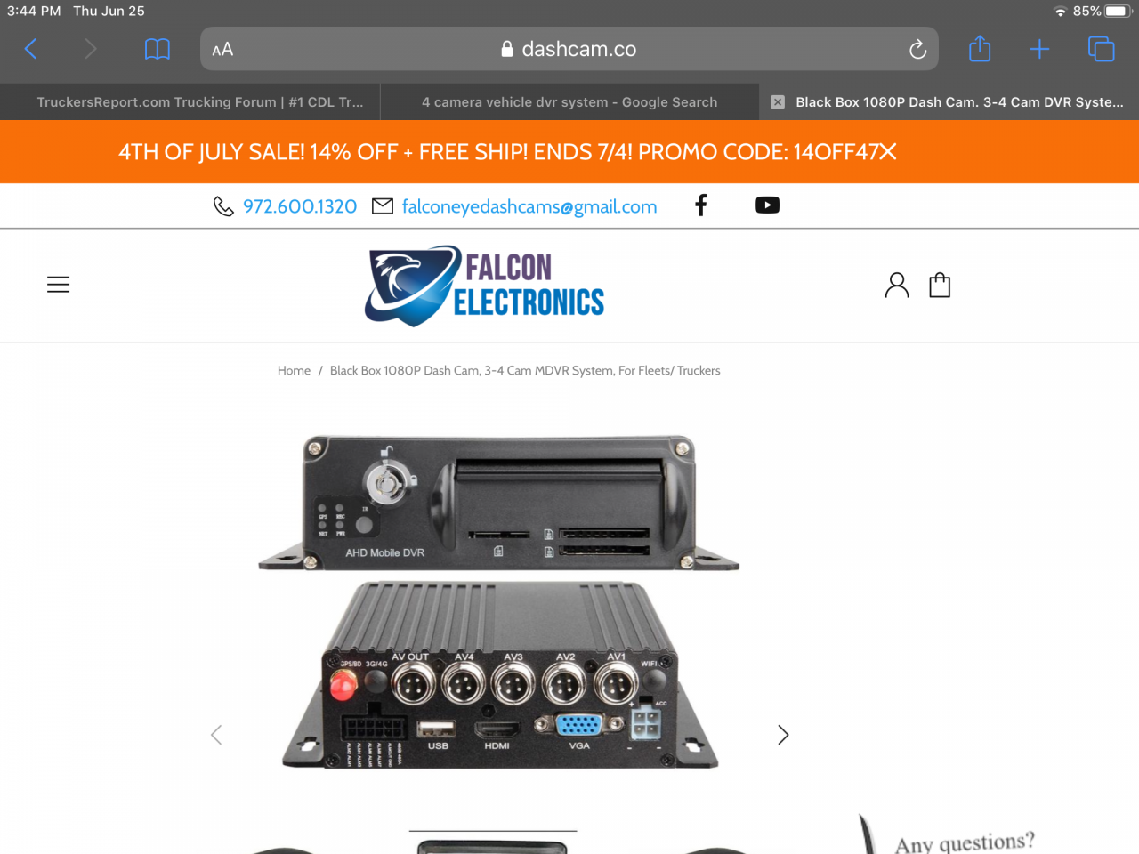

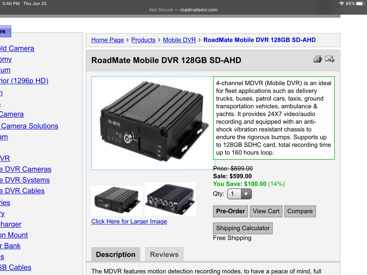

    I don’t have a recommendation in the $200-$300 range. I purchased a 4 camera system at the Mid American Truck Show about 4 years ago for roughly $500. It was from Roadmate and did very well until recently. One of the video output connections jarred loose from the DVR rendering the system inoperable. I probably could have fixed it but I got my money’s worth from the system. I also went from a 7” monitor to a 9” monitor and it is much better when viewing four cameras at once. I replaced it with a system from Falcon Electronics. It seems to be very similar but the connector that went bad on the old system is heavier constructed on this system. I feel the price range is very worthwhile as several years ago I was sideswiped. I received $21,000 in loss of use pay while my rig was in the body shop due only to the video evidence I had in hand. The Amazon system may have worked, but I am not taking the cheap route when it comes to cameras for my rig. Both of the systems I have the SD card is downloaded on the computer and the footage can be accessed for free.
    On a side note I didn’t need to cut any of the cables during installation. I used a hole saw large enough to run the connector and all of the cables through the firewall and then used silicon to seal the hole when I was finished. I have also learned that it is important to put 3-1 heat shrink over the connectors. They are water proof, but after a year or so moisture does still get in and will ruin the connector if you let it go due to corrosion. Dialectric grease does not work on the inside of the connector as the signal won’t go through, but can be used on the outside to keep moisture out. If one camera starts to act up, use electrical connector cleaner to clean up the connection and reseal it to extend the life of it.

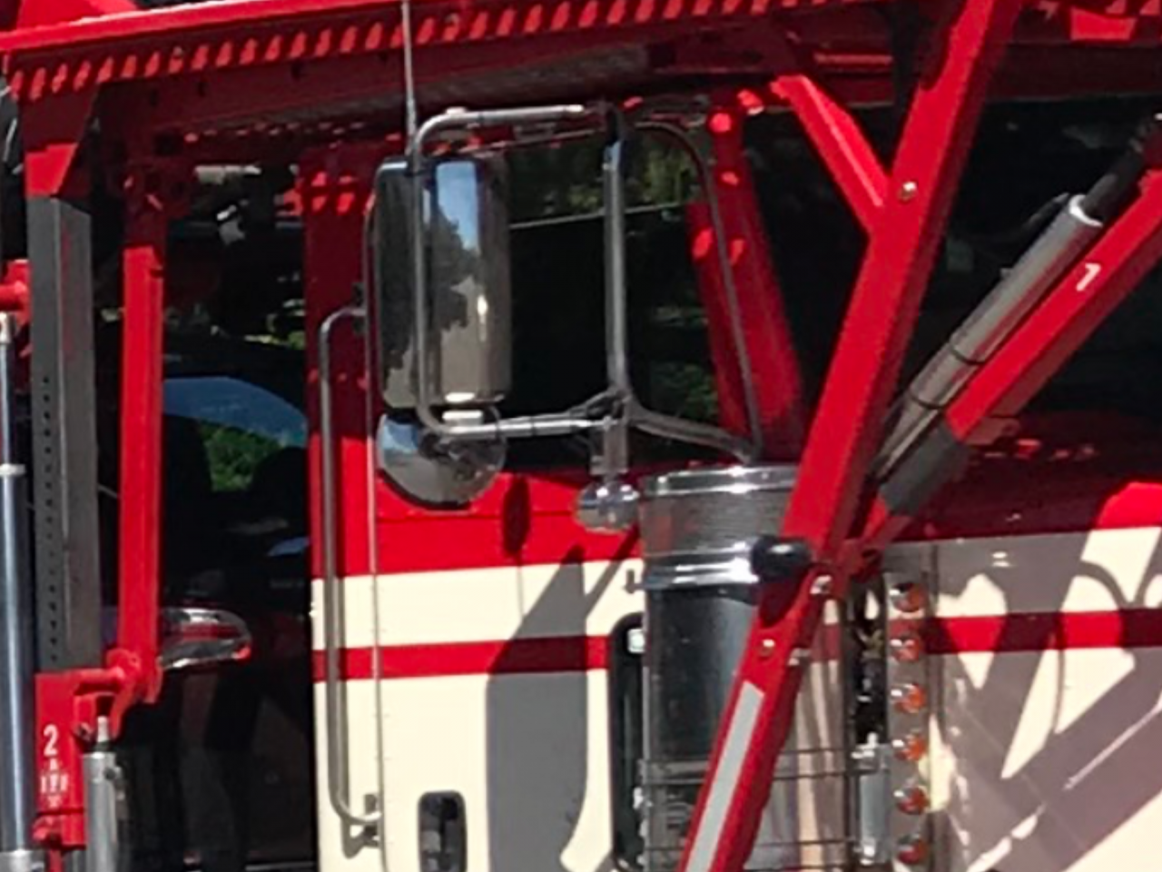

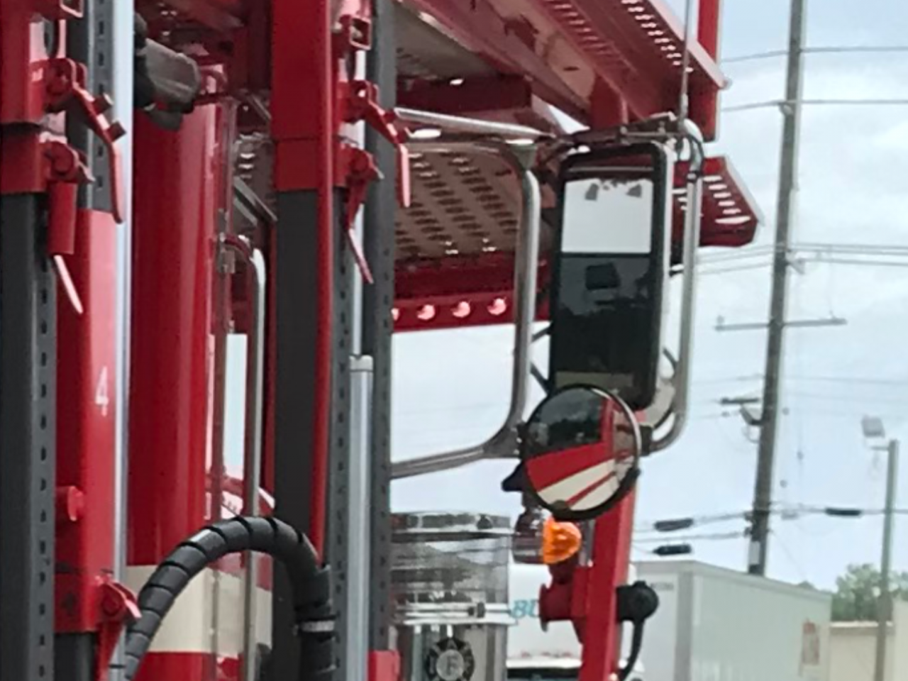

    My side cameras are mounted on the post near the air cleaners. For a normal rig you will find another place as far forward as possible to get the best side view. 7BC57615-C931-453C-BBCE-B76395FC4C78.png 07030D76-F8E0-4722-BCF0-D83A87590C92.png
