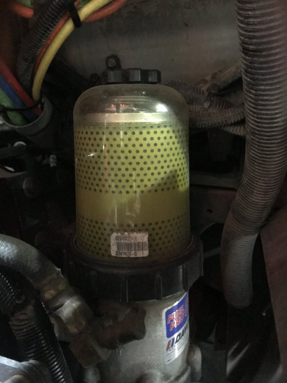

    5C2F8577-F22E-4C5F-A83E-3E216FEB87F2.jpeg During my pretrip I checked out the fuel filter and it seems like the diesel fuel is higher up on the filter then it was last time I checked it. Does this mean anything at all? Why is this cover even transparent in the first place?

    Yes when the fuel gets near the top of filter its time to change it, your are near that time to change your filter now!

    I suspected as much. I have a hot load and 400 miles to go. What happens if it gets to the top?

    Nothing, it has a bypass in the filter.
    That's a secondary filter, so get it changed when you can.

    I think if it gets full it will bypass the filter and you will have unfiltered fuel going to the main filters. But you should be ok for today

    It won't hurt anything, just get it changed out like others said.
    Transparent is so you can see water levels (it collects at the bottom and can be drained) and so DOT can see if it is stained red from running offroad fuel. ;)

    If you actually change it yourself, have a bucket ready to catch the diesel. I watched some clown take the filter ring off and had diesel all over the place, he just dumped the filter, put the new one in, closed everything up and had a cop standing there when he could not get his truck started to get out of there.
