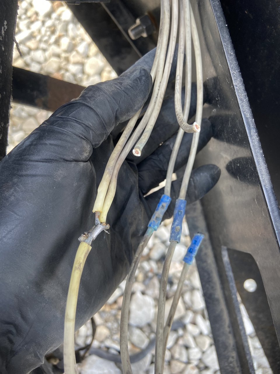

    Will have all new wiring when the new engine is installed. Hopefully within the next month.

    Wow. Workplace ##### slaps should be acceptable when someone is found to be incompetent. Maybe with mechanics, smash fingers with their favorite ratchet.

    Nothing a little solder and some tape can’t fix.

    No way. Did it the proper way. New connectors. Heat shrink. Then tape. If any water gets in there it deserves to be there LOL.

    I have always liked the combo crimp and solder connectors. The solder is usually low temp, with enough to do a good job. Then use a quality silicone sealant followed by heat shrink.

    Thats the ones I used. I like them because you can crimp first and they stay in place. The solder only ones I have messed up a few because I didn’t realize the wire slipped out. These were Grote brand, Made in USA. Most of their smaller stuff is made in china.
