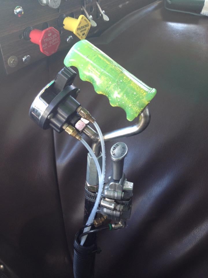

    I drove several trucks with that type shifter setup, 13 speeds. Back in the 70's and 80's. I really liked it , wish I could do something like that on the truck I'm driving now.
